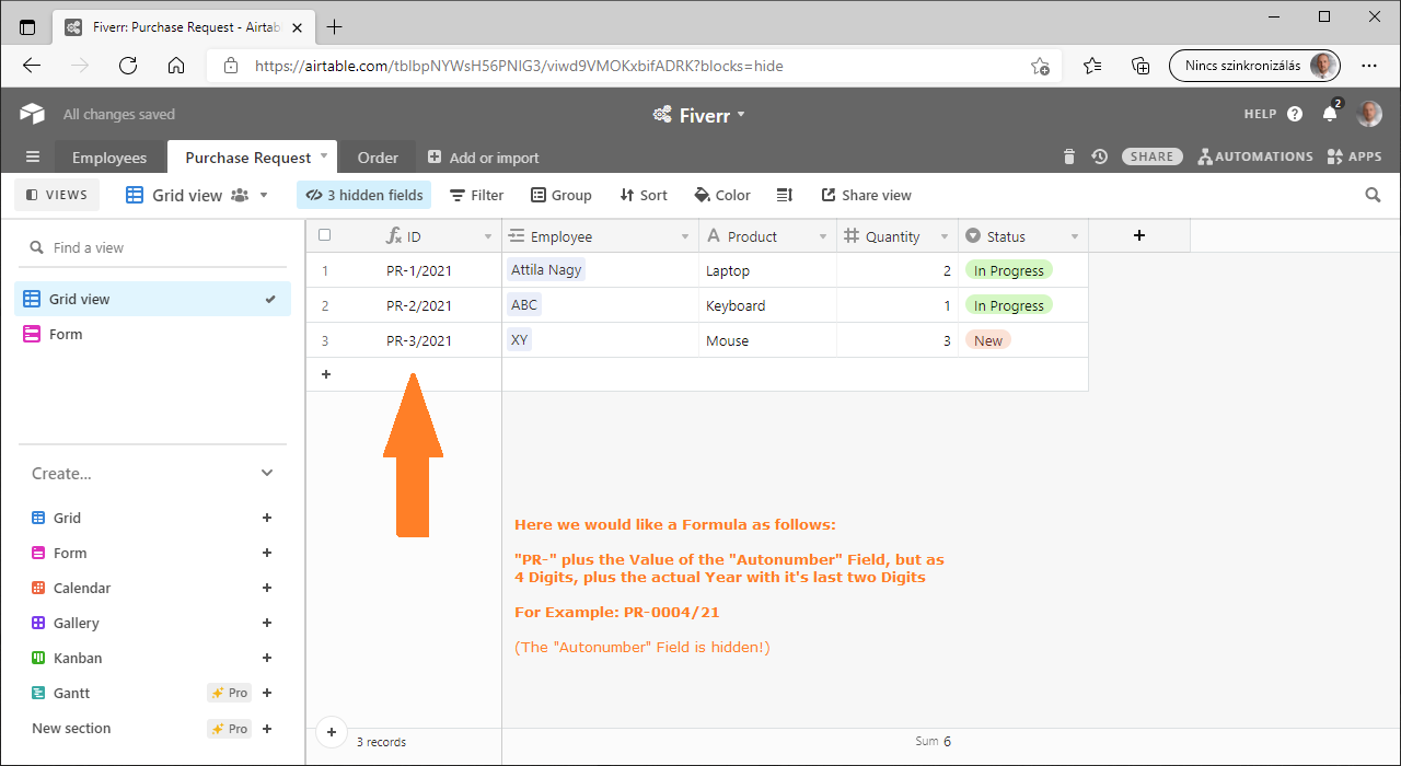

Hello!

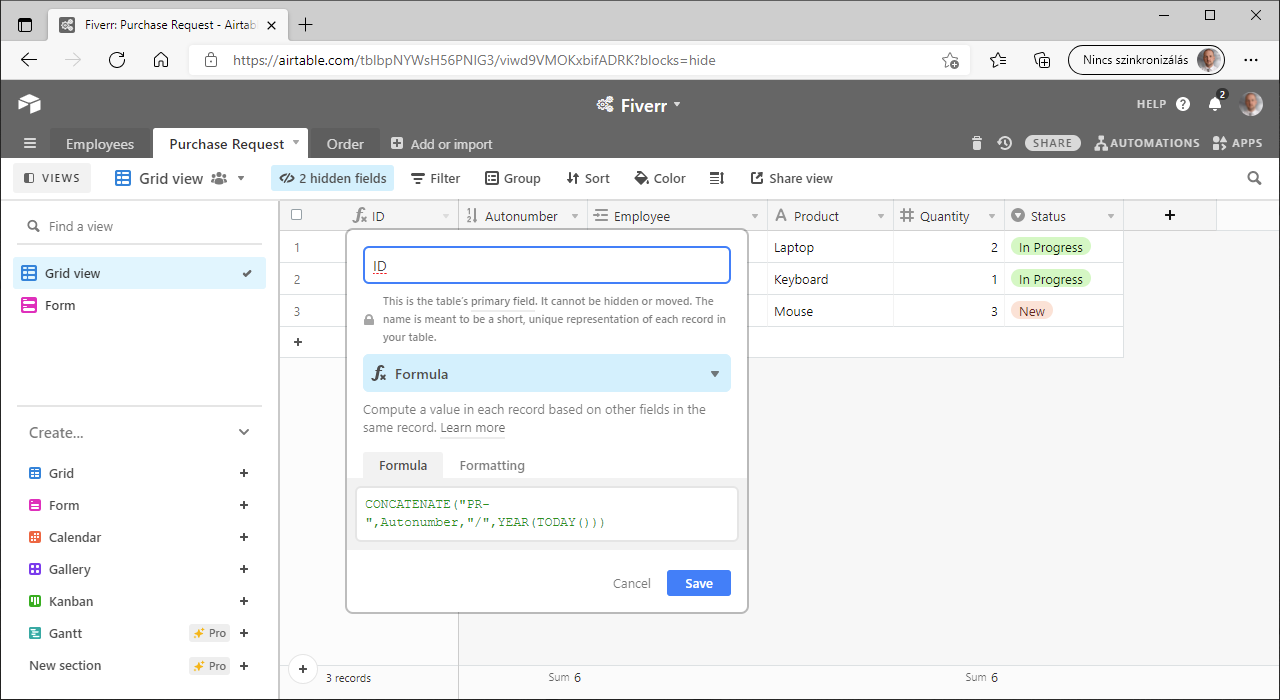

I want to have a Formula as the Secondary Field. Now the Formula is:
CONCATENATE(“PR-”,Autonumber,"/",YEAR(TODAY()))
The “Autonumber” is a Field as Autonumber.
How can I achieve, that the “Autonumber” in the CONCATENATE is always 4 digits long, independent of it’s length. Besides that I want only the two second digits of the year.
So the values of the Autonumber is “4”, I want: “PR-0004/21”
Thank you for your help in advance!
Best regards
Attila

Welcome to the community, @Attila_Nagy! :grinning_face_with_big_eyes:
I used to use one method for adding leading zeros until I saw a nifty trick from @Kamille_Parks recently. Replace your {Autonumber} reference with this: RIGHT("000" & Autonumber, 4)
This can be achieved using a similar trick. First concatenate the year with an empty string to turn it into a string, then get the right two characters: RIGHT(YEAR(TODAY()) & "", 2). This also uses the more compact & concatenation operator instead of the CONCATENATE() function.
Applying all of this to your original formula gives you this:
"PR-" & RIGHT("000" & Autonumber, 4) & "/" & RIGHT(YEAR(TODAY()) & "", 2)
