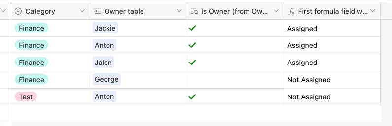

I would suggest your owner is a linked record to your people table.  Then have a an attribute of those people that allows them to be approved owners of the case. The formula would be the same as I put up above where owner is a lookup field from the linked owner person field.

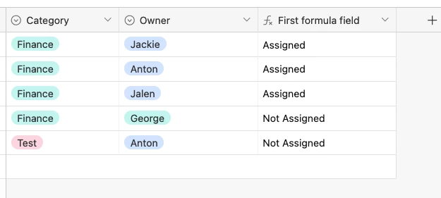

I've set up a base here that does what you're looking for, and you can duplicate the base to your own workspace to play with it!
First formula:
IF( AND( Category = "Finance", OR( Owner="Jackie", Owner="Anton", Owner="Jalen" ) ), "Assigned", "Not Assigned" )

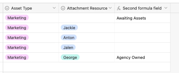

Second formula:
Second formula field
And I also put in Dan's recommendation of using a linked field:
