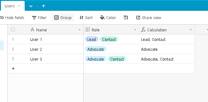

Is there a reason that the options are checkboxes?
Why not a multiselect or link to another record. Then you would not need a formula at all.
In any case, post your current formula and I can try to help you remove the commas.

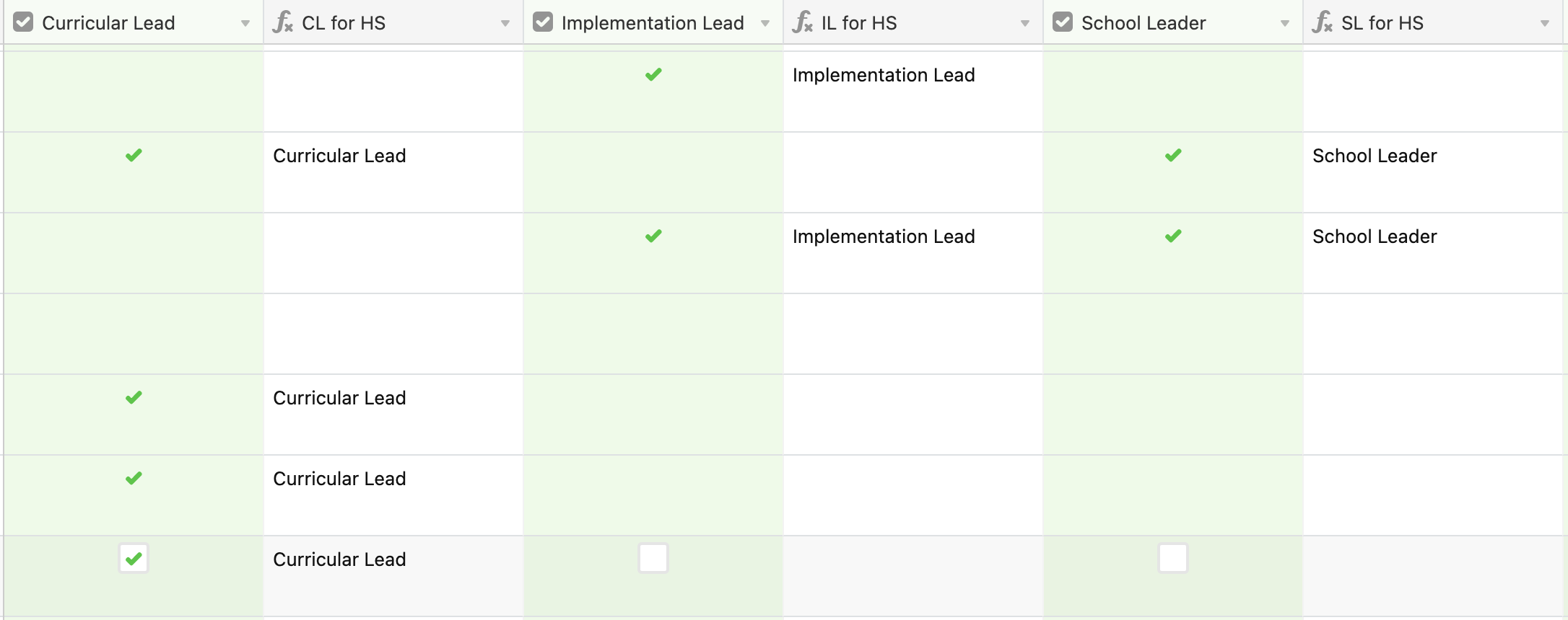

unfortunately I need to keep the checkboxes for some integrations that run off of it. I do, however, have some formula fields with the correct words showing. Those formulas are: IF({Curricular Lead}=1
,“Curricular Lead”)

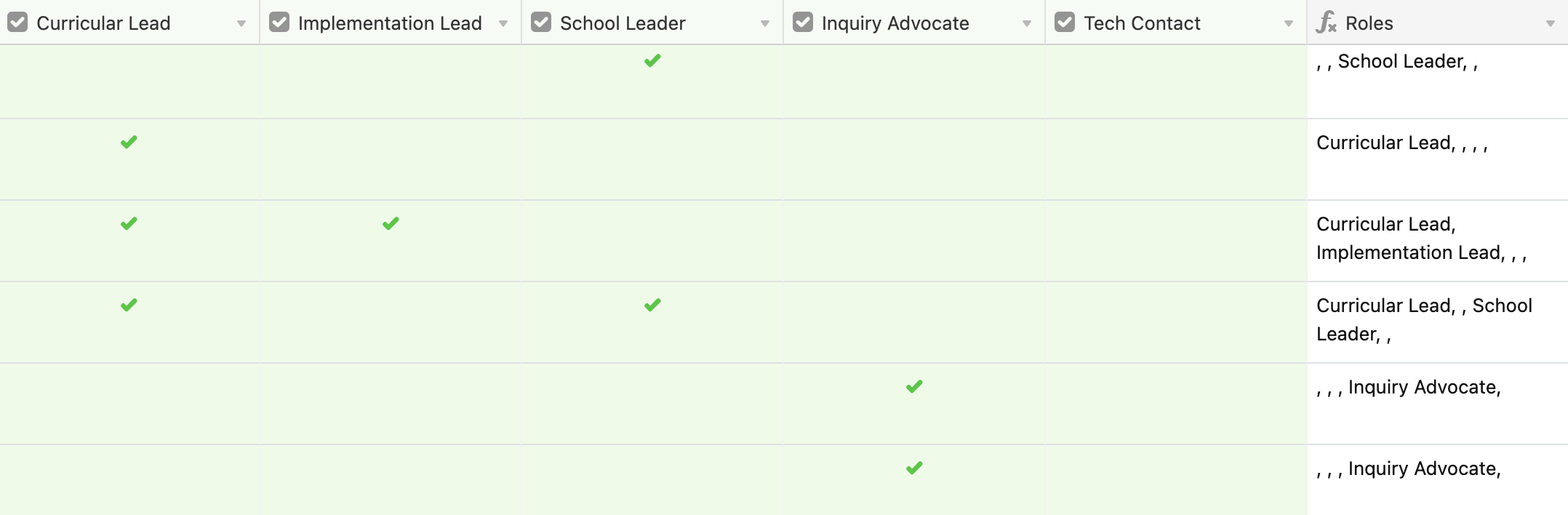

The formula in the prior screenshot is coming from those: CONCATENATE({CL for HS},", “,{IL for HS},”, “,{SL for HS},”, “,{IA for HS},”, ",{TC for HS})
I’m assuming I need many IFs for this to work, but everything I try gives me an error.
