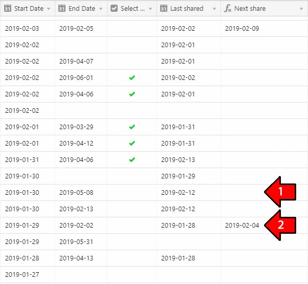

When using the second version of the first formula you provided I run into the following:
  1. No {Next share} date apear though it should have added 14 days to the {Las shared} date
  2. It returns a date that is after the End date.
Unfortunately my brain has taken a vacation due to a combination of illness and lack of propper sleep making me stare dumbly at the formula instead of being able to figure it out.
