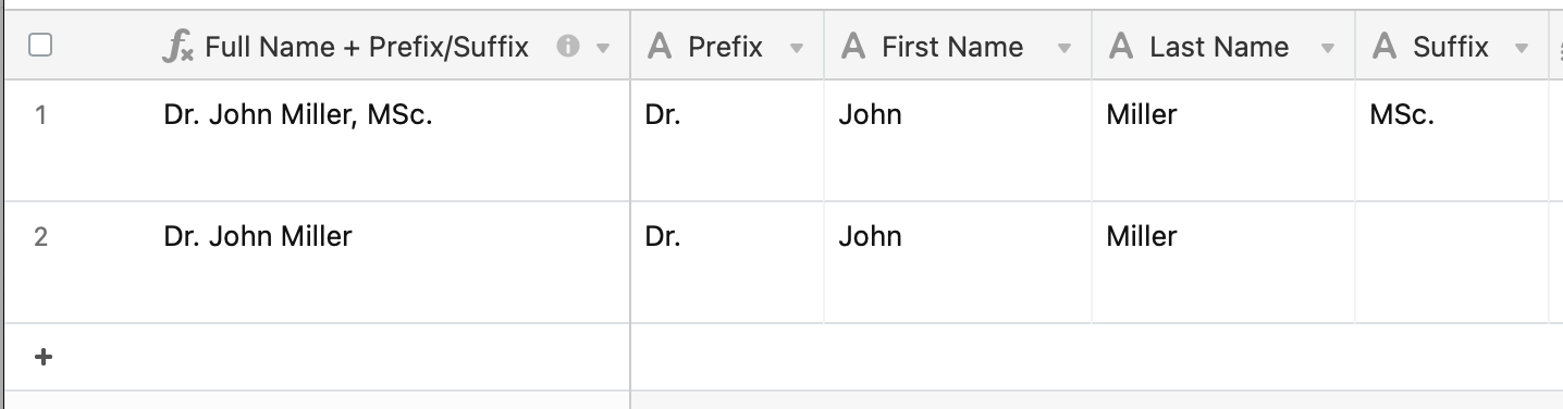

For example:
  1. Prefix (Dr.), First Name (John), Last Name (Miller), Suffix (M.Sc.) - Formula Result: Dr. John Miller, MSc.
  2. Prefix (Dr.), First Name (Leroy), Last Name (Thompson), Suffix (null) - Formula Result: Dr. Leroy Thompson

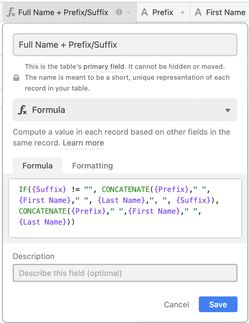

Hey @Juraj_Ivkovac,
If I have understood correctly, you’re correct in that you want to use an IF statement as below.
IF(Suffix != “”, CONCATENATE({Prefix}," “,{First Name},” “, {Last Name},”, “, {Suffix}), CONCATENATE({Prefix},” “,{First Name},” ", {Last Name}))
What the above formula is doing is:
IF the Suffix field is not equal to “null”, Concatenate these fields
{Prefix}," “,{First Name},” “, {Last Name},”, ", {Suffix})
Otherwise, IF it is null, only concatenate these fields
{Prefix}," “,{First Name},” ", {Last Name}
I hope that helps! :slightly_smiling_face:
Thanks,
Adam

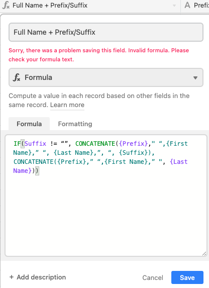

Hey @Adam_Mintram :slightly_smiling_face:
Thank you very much for your guidance.
For some reason it´s not working for me … is there maybe a small syntax problem?
  • September 10, 2022
Hey,
Oh that’s strange! I wonder if the first Suffix needs {} around it.
It is working for me so I wonder if my field names are slightly different to yours.
Otherwise, if you delete and then try to manually input the formula (using the existing as a reference) to ensure it links all the fields ok.
Let me know how you get on? I will see if I can find anything else in the meantime.
Adam

  • September 11, 2022
Hey @Adam_Mintram,
Thanks for your screenshot. Now I have found the error. By copying your code probably a wrong formatting for the quotes was transferred and in further consequence the code was corrupted. If you look at the quotes in my code, you can see that they have different formatting.
Problem solved - Thank you very much, I am very happy with the result. :grinning_face_with_big_eyes: Thanks also to @Ben.Young !
