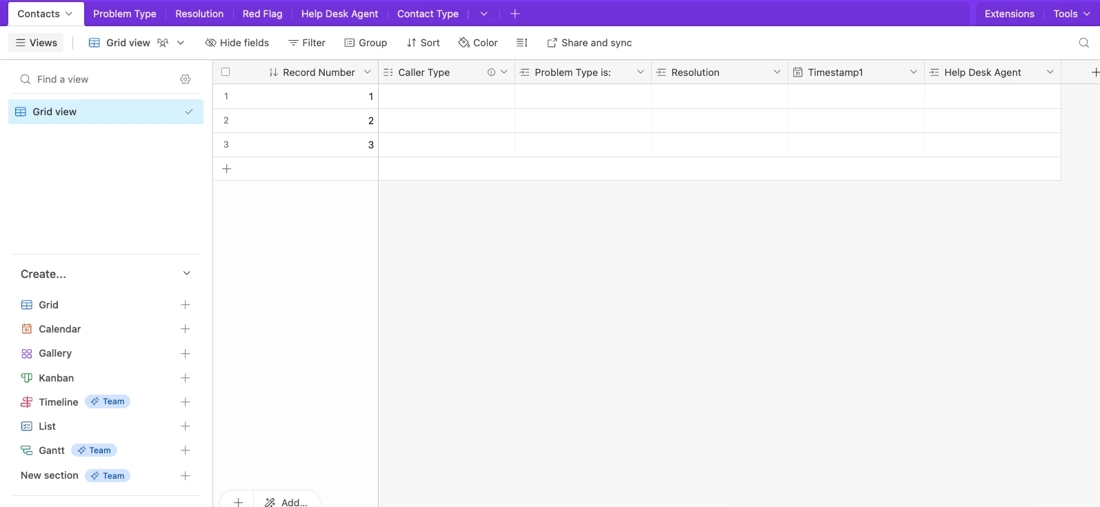

I'm super new to airtable and I've been searching for the answer to this and I can't seem to find what I am looking for- likely because I don't know the right terminology but I have a table in my base and I want the primary field to auto populate each new record with a number and the year the record was created so that if there are multiple years I can filter them easily later.
I figure it's some sort of formula because I know how to make the field auto number, but I can't figure out the formula to do it.
Thanks in advance Amy

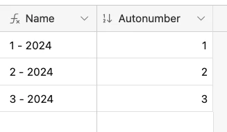

Try this:
Autonumber & " - " & YEAR( CREATED_TIME() )
Link to base

Thank you so much! That is exactly what I was trying to do!
