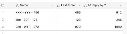

Tamas,
I think this should work for you:
The formula for the "Last three" field is simply
RIGHT(Name, 3) + 0
Ron_Daniel

Hi Ron,
the issue with RIGHT(Name, 3) is that I have 1 and 2 digit numbers as well, so i.e. for XXX - YYY - 1, it would give "- 1" as a result. BUT I've used your suggestion to add "+0" to the end of my formula and it worked! There are some weird things in Airtable for sure.....
Thank you very much!

For anyone running into this in the future, the formula using a regular expression would be
REGEX_REPLACE(Name, "[^\\d]{1,3}","") + 0
