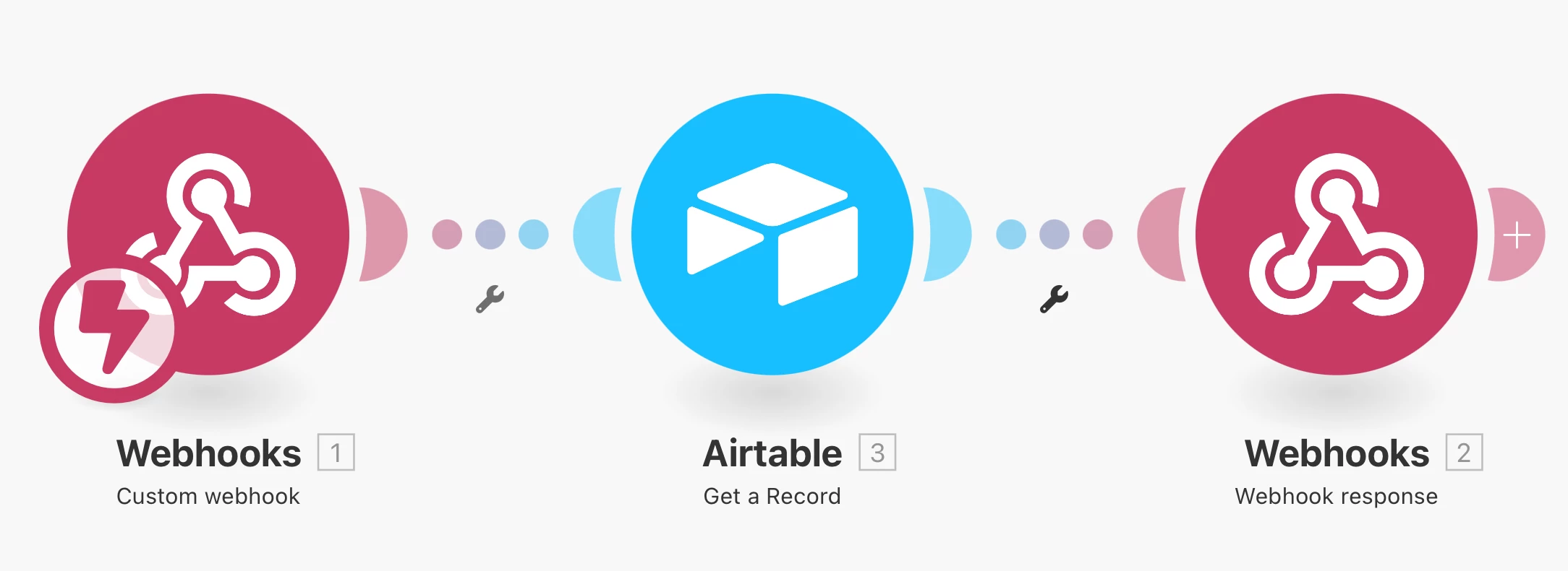

ohh okayy, thank you ScottWorld, do you think there is a way to do it through make.com instead of fillout? since i will be using make.com for other functions as well!
  • Jun 19, 2025 2:19 PM UTC
​@BuenaVista
That is a fantastic idea that I hadn’t thought about! I love Make, and I always recommend that everybody use it for all of their automations and integrations!
Normally, Make does not have a user interface that you can use to show Airtable records to your employees.
But there is one exception to this rule:
You can use custom webhook responses to display information to your users in their web browser.
If you setup a scenario in Make that starts with a custom webhook, Make will give you the URL that you would give to your employees. You would just need to create a formula in Airtable that attaches the Airtable Record ID as a URL parameter to the end of the URL.
Then, you can use Make to display all the record information to your employees in their web browser by using Make’s webhook response module.
Your scenario would be as simple as my screenshot below.
