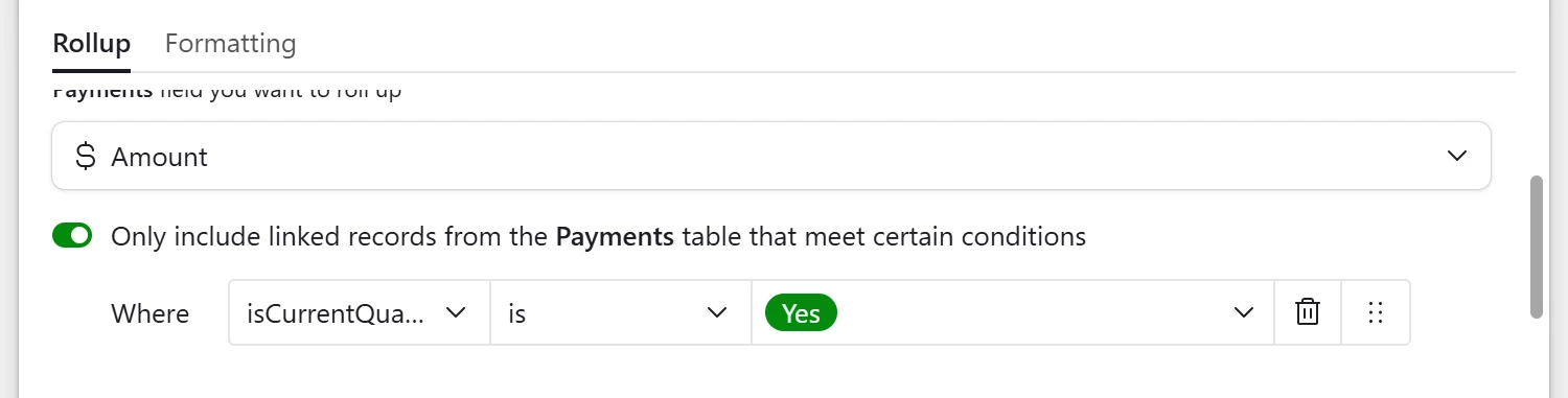

2. In Projects, create a new rollup "Total this Quarter" that only sums the payments where isCurrentQuarter is Yes

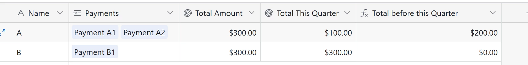

3. Add a new column formula in Project that's Total Amount - Total this Quarter to get the total amount as of the end of the prev quarter

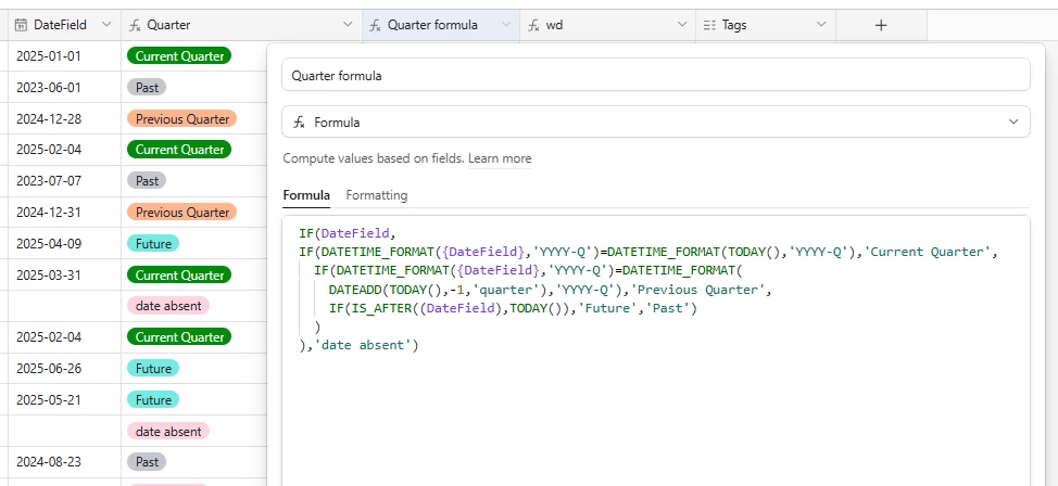

Here is expanded formula, based on idea by @ibayub
You can use it in rollup built-in filter, like one field shown total of current, next - total of previous quarter, etc..
Version to copy
IF(DateField, IF(DATETIME_FORMAT({DateField},'YYYY-Q')=DATETIME_FORMAT(TODAY(),'YYYY-Q'),'Current Quarter', IF(DATETIME_FORMAT({DateField},'YYYY-Q')=DATETIME_FORMAT( DATEADD(TODAY(),-1,'quarter'),'YYYY-Q'),'Previous Quarter', IF(IS_AFTER((DateField),TODAY()),'Future','Past') ) ),'date absent')
