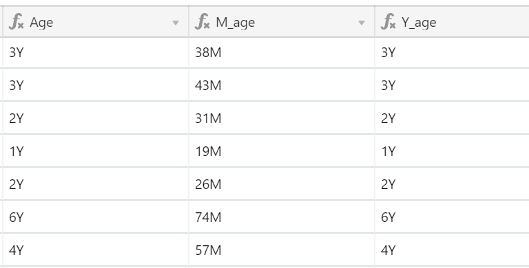

Hi all just trying to decide if AirTable will work for our businesses. So far so good except for this snag. We are in childcare and NEED to calculate our babies ages in Months not years based on TODAY().
This is the section of the child table so far, I want the Age field to return ages under 3yrs (<=35months) in months and the rest in years…
Formulas so far
M_age DATETIME_DIFF(TODAY(),{C1_DOB},‘M’) &“M” (works fine)
Y_age DATETIME_DIFF(TODAY(),{C1_DOB},‘Y’) &“Y” (works fine)
Age I’ve tried… to get under 3 years in Months and over in years:
IF(M_age <= 35,(DATETIME_DIFF(TODAY(),{C1_DOB},‘M’)&“M”),Y_age)
IF(M_age <= 35,M_age,Y_age)
No matter what I do the age field returns age in years.

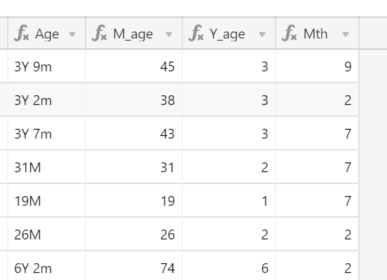

  • May 10, 2020
Thanks so much, of course it is was the text vs integer, I actually just removed the & “m” and the formula worked so M_age and Y_age are both integers and easier to work with. This is what I ended up with.
(added the round function to eliminate decimals)
M_age ROUND(DATETIME_DIFF(TODAY(),{C1_DOB},‘M’),0)
Y_age DATETIME_DIFF(TODAY(),{C1_DOB},‘y’)ROUND(M_age-(Y_age*12),0)
Age IF(M_age <= 35,(DATETIME_DIFF(TODAY( {C1_DOB},‘M’)&“M”),CONCATENATE(Y_age&"Y ",Mth&“m”))
