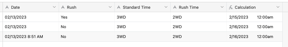

Assuming "WD" stands for a day or something, try something like:
DATEADD( DATETIME_PARSE( Date, "MM/DD/YYYY" ), VALUE( SUBSTITUTE( SWITCH( Rush, "Yes", {Rush Time}, {Standard Time} ), "WD", "" ) ), 'days' )
 Link to base
  • February 16, 2023
 Link to base

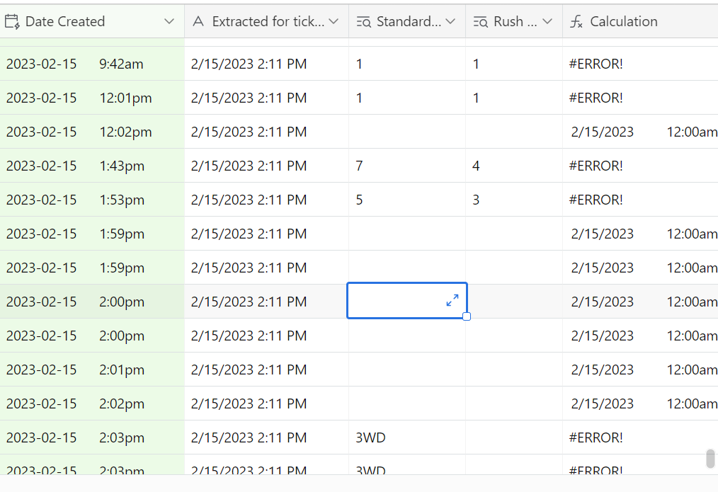

Hi @TheTimeSavingCo,
When I applied the formula, the date and time were not the values that I wanted. I believe the column "Extracted for Ticketing" has a time that is why an error would occur when the formula would be applied.

Hm, that shouldn't affect anything:
Could you provide a screenshot of the error you're seeing when you try to use the formula? 

Hi @TheTimeSavingCo ,
Here
Here
At a glance I can't see anything wrong there.  Could you send me an invite to your table so I could troubleshoot it from there?
