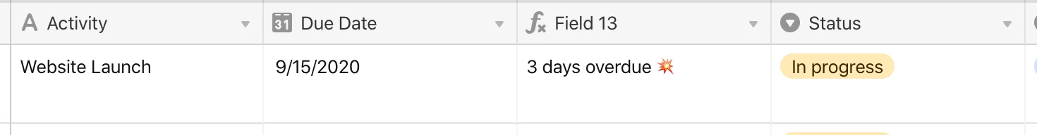

Thanks for all the help with this. Why would it say overdue by 3 days when it’s really only overdue by 1 day? This is the main issue I’m referring to.
Ah, I didn’t catch that. That’s very strange. The WORKDAY_DIFF() function is supposed to not count weekends, but apparently it is. I’ll have to play with this later and see if I can figure out what’s going on.

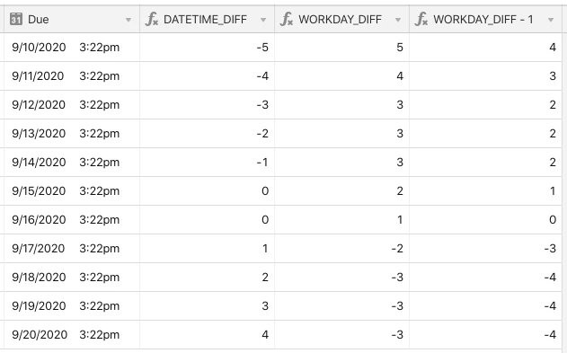

This should illustrate the problem:
I don’t understand why WORKDAY_DIFF() doesn’t count a difference against TODAY() or NOW() as 0, and uses 1 instead. On top of that, I don’t know why it jumps from 1 to -2.
In my mind, I thought, “Using DATETIME_DIFF never causes problems like this!” But then I tested it, and was proven wrong. Notice the two records with a difference of 0, even though they’re different days:

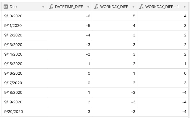

“Okay,” I thought. “I just need to add my local time and everything will correct itself.”
Nope. It just moves the problem by one day.
To quote Pepe Le Pew, “Le sigh.”
Anyway, your problem is coming because you’re subtracting 1 from the WORKDAY_DIFF() total so that you can test against zero for the “Due today” option. Subtracting 1 from a negative number (for overdue tasks) means it goes farther away from zero, effectively adding a day to the calculation. That, on top of the already-shifted negative value offset that starts counting at -2, is why the number feels like it’s two days off (see the far right column, where it goes 2, 1, 0, -3, -4, etc.).

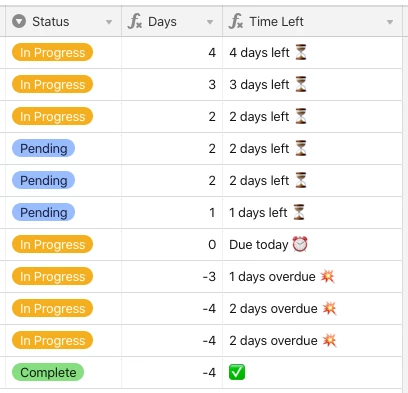

I suggest leaving your {Days} calculation alone, and correcting the issue in the other formula:
IF(Status = "Complete", "✅", IF(Days = 0, "Due today ⏰", (ABS(Days) - (2*(Days < 0))) & IF(Days > 0, " days left ⏳", " days overdue 💥")))
Even though the {Days} value is still wonky, the formula now produces the correct output:

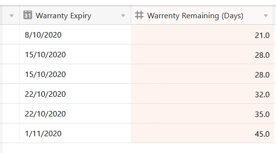

I had tried DATETIME_DIFF({Warranty Expiry}), TODAY() on the below to work out how many days are left on the warranty, see table excerpt below. I’m pretty new to this so not sure where I’m going wrong!
Your screenshot shows a date field and a number field, but no formula field. The formula you listed is written incorrectly, so my gut says you’re going from memory on an old test that you removed from the base. Either that, or you converted the formula field to a number field after the calculation was done.
The DATETIME_DIFF() function requires three arguments: two dates, and a units indicator as a string (e.g. “days”, “weeks”, etc.). To calculate how many days are left between today and a date from a date field, it should look like this:
DATETIME_DIFF(Date, TODAY(), "days")
When I use that on a date field with the dates you listed, here’s the result:
If you leave the formula field intact, it will update continuously with the remaining days on each warranty.
