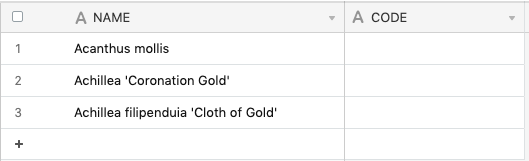

Given this sample data…
Is this kind’a what you’re attempting to do?

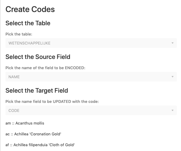

The trouble with using a formula to do this is that it will require some array handling and Airtable lacks Split(), so it’s far easier to accomplish this in Javascript using a Script Block. But this has downsides as well as you must actually run the script to update the fields and you have to know some javascript to modify this to meet more specific use-cases.
The Script…
   Airdrop - Code Builder
   Copyright (c) 2020 by Global Technologies Corporation
   ALL RIGHTS RESERVED
// display the title
output.markdown('# Create Codes');
// get the table name
output.markdown("### Select the Table");
let sourceTable     = await input.tableAsync("Pick the table:");
let sourceTableName = sourceTable.name;
// get the source field name
output.markdown("### Select the Source Field");
let sourceField = await input.fieldAsync("Pick the name of the field to be ENCODED:", sourceTable.id);
let sourceFieldName = sourceField.name;
// get the target field name
output.markdown("### Select the Target Field");
let targetField = await input.fieldAsync("Pick the name field to be UPDATED with the code:", sourceTable.id);
let targetFieldName = targetField.name;
// get the data set for this gallery
let result = await sourceTable.selectRecordsAsync();
let sourceRecords = result.records;
// get the record count
let recordCount = sourceRecords.length;
// iterate across all the records
for (var r = 0; r < sourceRecords.length; r++)
    // get the name of this item
    var thisName       = sourceRecords[r].getCellValue("NAME");
    var thisNameTokens = thisName.replace(/'/ig, "");
    // compute the code
    var thisCode = thisNameTokens.toString().split(" ")[0].substring(0, 1) + thisNameTokens.toString().split(" ")[1].substring(0, 1)
    thisCode = thisCode.toLowerCase();
    output.markdown(thisCode + " :: " + thisName);
    await sourceTable.updateRecordAsync(sourceRecords[r].id, {
                [targetFieldName] : thisCode

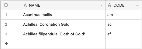

Thanks, I will try. It’s enough to run the script once, after that I will type on new entries. Don’t know yet how to run a script, but I’ll try to find out.

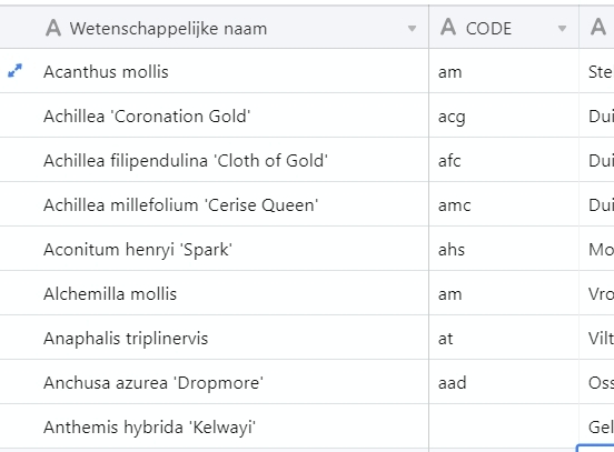

Thank you! It worked, had to change the field name from name tot Wetenschappelijke naam, but then I got my plantcodes.
It now creates the code from the first two fields, so two characters. Is it difficult to create it with the first three fields, to get a three-characters code. The code will be more unique then.
I’m very happy until now! Thanks again.

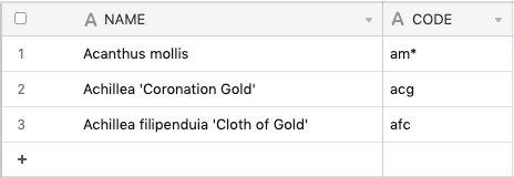

var thisCode = thisNameTokens.toString().split(" ")[0].substring(0, 1) + thisNameTokens.toString().split(" ")[1].substring(0, 1) + ((thisNameTokens.toString().split(" ")[2] == undefined) ? "*" : thisNameTokens.toString().split(" ")[2].substring(0, 1));
Resulting in this output -
