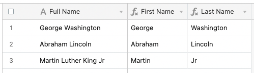

Well, it's less than ideal, but you can make it work (mostly) like this:
First Name formula is
IF(FIND(" ",{Full Name})=0, {Full Name}, LEFT({Full Name}, FIND(" ",{Full Name})-1))
Last Name formula is
REPLACE({Full Name},1,FIND("~",SUBSTITUTE({Full Name}," ","~",LEN({Full Name}) - LEN(SUBSTITUTE({Full Name}," ","")))),"")

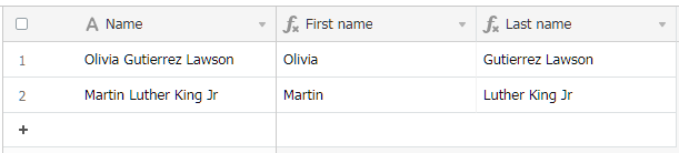

try this:
First name: REGEX_EXTRACT(Name, "^[^ ]+")
Last name: REPLACE(Name, 1, LEN({First name}) + 1, "")

Cole_Wedemeier
Forum|alt.badge.img+13
try this:
@Steve_Haysom THANK YOU! That works like a dream and I would have NEVER come up with that myself.
