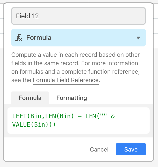

Thanks @Bill.French - very kind but actually I misread the question! Although of course your suggestion that this allow you to find the length is clearly the way forward.
However, there is one issue and that is that the LEN() function doesn’t work on a number - so you need to convert the VALUE(Bin) (I’ve used a field called Bin for the whole Inventory Number) to a string by adding a Zero length string ("") to it. The formula then ends up as:
Turn’s out it wasn’t so obvious but hopefully this should be the answer.
