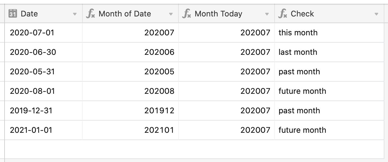

@Jason_Burke1, @ScottWorld - I’m sure there’s a few different ways to approach this, but here’s one that gets over the issue Scott identified:
I have two columns that show the year/month as an integer value. The formulas are:
VALUE(DATETIME_FORMAT(Date, 'YYYYMM'))
and
VALUE(DATETIME_FORMAT(TODAY(), 'YYYYMM'))
So we can compare the “value” of today with any arbitrary date. The final formula is this:
  {Month of Date} - {Month Today} = 0,
  'this month',
    {Month of Date} - {Month Today} = -1,
    'last month',
      {Month of Date} - {Month Today} < -1,
      'past month',
      'future month'

@JonathanBowen Actually, it looks like your formula won’t work if you’re comparing December of one year to January of the next year. For example, December 2019 to January 2020. It won’t yield “last month”, it will only yield “past month”. This was my dilemma, too… comparing a sequential December and January.
To trap for that scenario, we would need to compare the month of date #1 to the month of date #2, along with the year of date #1 to the year of date #2.
JonathanBowen
@ScottWorld ah, yes, you are right, because both the month and the year increment, so the difference is more than 1.

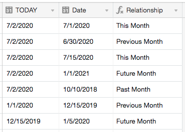

Here’s what I came up with. This was fun to play with, but as has already been discussed, it was tricky covering all possible options.
    Date,
        Date < TODAY(),
            MONTH(Date) < MONTH(TODAY()),
                MONTH(TODAY()) - MONTH(Date) = 1,
                "Previous",
                "Past"
                MONTH(Date) > MONTH(TODAY()),
                    (MONTH(TODAY()) + 12) - MONTH(Date) = 1,
                    "Previous",
                    "Past"
                "This"
            Date > TODAY(),
                "Future",
                    YEAR(Date) > YEAR(TODAY()),
                    "Future",
                    "This"
            "This"
    ) & " Month"

Ok, I feel like the biggest idiot.
When I saw your formula earlier today - I copied and pasted it right now and couldn’t get it to work. So then I said, “look at what the formula is doing and try to recreate it”, and of course that was a nightmare.
I just now realized, I didn’t copy the entire formula. The gray box the formula sits inside of, gives me no indication there’s more hidden text. It was only when I copied it again, and my cursor just to happen to scroll past the bottom did a slider bar on the right side appear and then I saw the rest of your code. OMG! haha!
Thank you for all your help! It’s working beautifully!

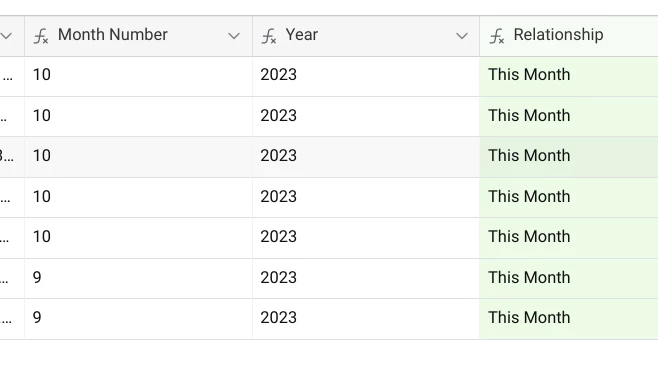

  • October 3, 2023
    Date,
        Date < TODAY(),
                "Previous",
                "Past"
                    "Previous",
                    "Past"
                "This"
            Date > TODAY(),
                "Future",
                    "Future",
                    "This"
            "This"
    ) & " Month"
Don't work.
