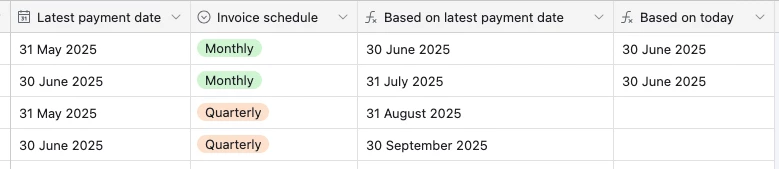

I'm curious what other invoice schedules you have though. If you have stuff like quarterly or like bi-monthly, you would need the latest payment date, right?  If so, maybe this might be useful:
SWITCH(
{Invoice schedule},
'Monthly',
DATEADD(
DATEADD(
DATETIME_PARSE(
DATETIME_FORMAT({Latest payment date}, 'YYYY-MM') & '-01'
2,
'months'
-1,
'days'
'Quarterly',
DATEADD(
DATEADD(
DATETIME_PARSE(
4,
'months'
-1,
'days'

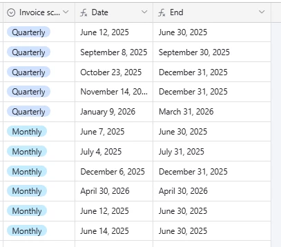

I like this topic :
To be honest, after I reviewed question, I have doubt what exactly needed. Anyway, that’s end of term based on Date field.
DATEADD(
DATETIME_FORMAT(
DATEADD(Date,1+
IF({Invoice schedule}='Quarterly',MOD(12-MONTH(Date),3))
,'M')
,'YYYY-MM-01'),
-1,'d')
