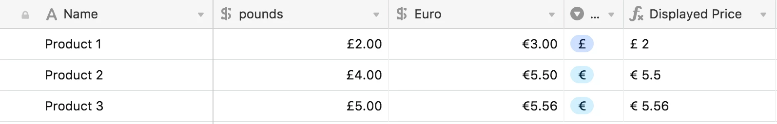

I’m trying to make a basic set up for switching between currencies when pricing a product
I’ve got 2 fields; one for € and one for £ and then a formula field that’ll show the price from the £ field or the € field depending if a ‘switch’ is set to £ or €.
I really want to show the displayed price with 2 decimals, but it doesn’t show a price is fx. 2.00.
I tried with the ROUND() function but doesn’t work - is there a way for 2 decimals in the formula field.
Currently, I’m using the following:
IF({Currency switch}=“€”, "€ " & Euro, IF({Currency switch}=“£”, "£ " & ROUND(pounds,2), BLANK()))

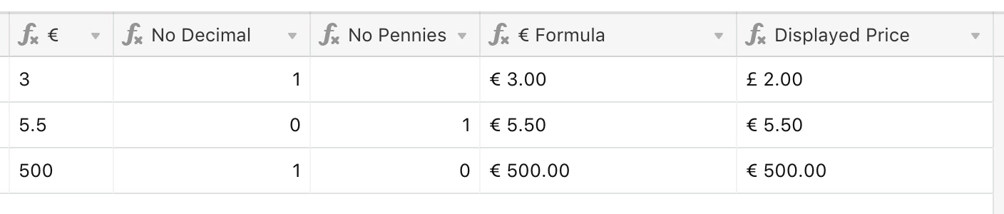

Thanks for the Christmas wishes! After a little break it took me a little while as well to understand my formula. (And I found the mistake I made) I’ve added tabs which should help a little:
IF({Currency Switch}='€', //check the switch
    '€ ' & Euro & //start joining the string for Euro
    IF(NOT(FIND('.',Euro&'')),'.00', //if you can't find a decimal add it and '00'
    IF(FIND('.',RIGHT(Euro&'',2)),'0')), //otherwise check if the decimal is in the last two add a zero
    //but if everything is okay we are just joining the string to nothing
IF({Currency Switch}='£',  //same as above, but pounds this time
    '£ ' & pounds &
    IF(NOT(FIND('.',pounds&'')),'.00',
    IF(FIND('.',RIGHT(pounds&'',2)),'0'))))
That helps to show that it’s just the same thing twice, but here’s a screen of a table that breaks out a few of the sub-steps:
Also just incase you want to copy paste here is the formula without comments:
  '€ ' & Euro &
  '£ ' & pounds &
Hope this helps. Also don’t forget the string joins inside each formula is important because it converts the number to a string ( ie: pounds&’’ )
