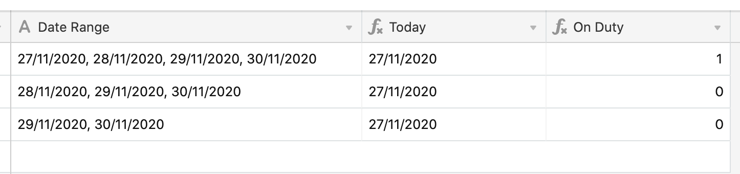

Hi @JonathanB - there’s a few tricks and one big problem with what you are trying to do. On the tricks side, once you have got the Date Range string you can do what you are asking:
In Airtable TODAY() is a date object so you need to parse this to a string to be able to compare it to the date range, so the {Today} field has a formula of:
DATETIME_FORMAT(TODAY(), 'DD/MM/YYYY')
Now, in the {On Duty} field, you can do:
IF(SEARCH(Today, {Date Range}), 1, 0)
The big problem you face is that you can’t use a formula to iterate over the items between a start and end date to get the date range string that you want. To do this you will need to use an Airtable script which could iterate between the dates and update a field with a string of all of the dates. This could be tied in with an automation to automatically produce this once the start and end dates have been entered.
