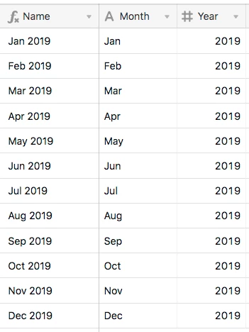

Anyway, that aside, the main thing I recommend is redesigning your base. First, make a [Summary] table where the primary field contains a combo of the month and year. I used separate {Month} and {Year} fields for the initial data entry, then used this formula in the {Name} field:
Month & " " & Year

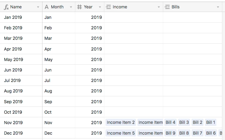

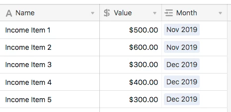

Next you’ll have your [Income] table. Instead of separate columns (fields) for each month, you’ll use a link field pointing to the [Summary] table to pick the relevant month for each income item:

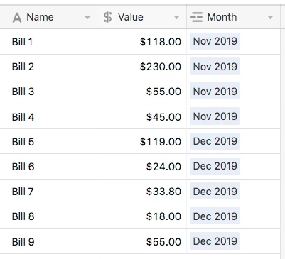

The [Bills] table would be set up the same way:
Now the Nov 2019 and Dec 2019 records in [Summary] have incoming links:

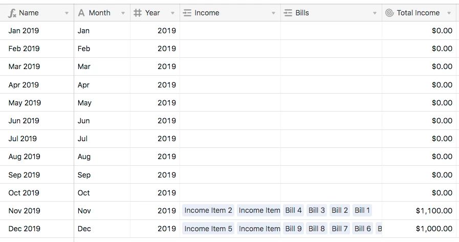

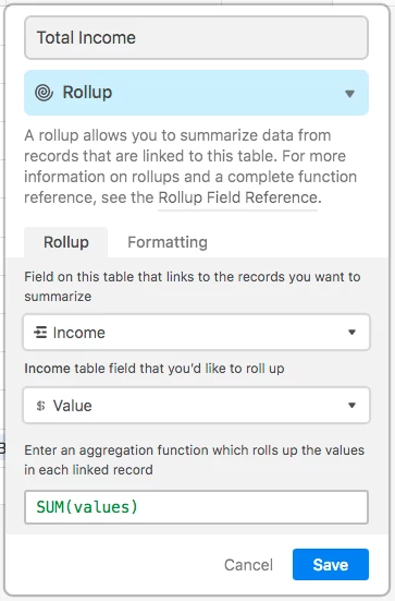

In that table, add a {Total Income} rollup field that sums the values from those linked items, and set its formatting to Currency:
This gives you a summary of all income, split by month:

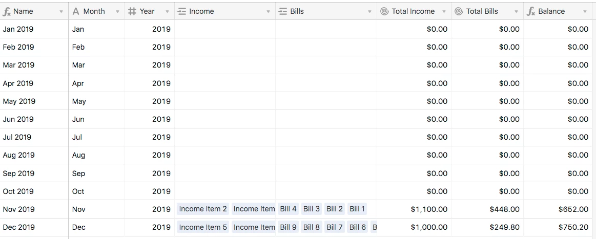

Make another rollup named {Total Bills} that does the same with the links in the {Bills} field, then add a formula field that subtracts the difference between the two rollup fields, which will give you this:
