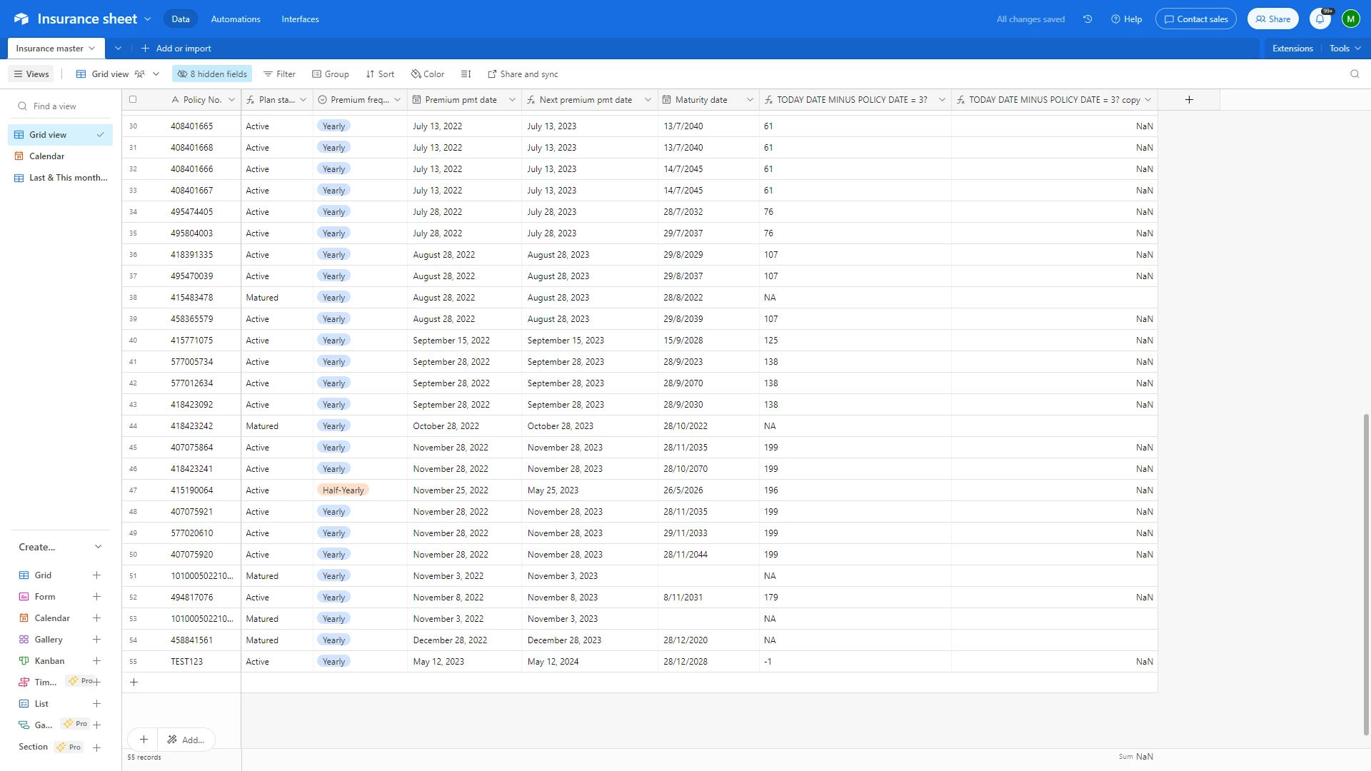

I am trying to create a formula which gives an output of difference between two dates (Premium date & Last month from Today date - as seen in the last 2 columns). The base is primarily used to manage my Insurance payments, so keeping that context in mind if its helpful.
The issue is - I have two Premium dates in my table (because some times Premium might be half-yearly frequency payment).
So, in order to get the difference in dates for only 1 date (Yearly premium) - I used the following formula:
IF({Plan status}="Active", DATETIME_DIFF(DATETIME_FORMAT({Premium pmt date},'DD-MMM'),DATETIME_FORMAT(DATEADD(TODAY(),-1,'month'),'DD-MMM'),'DAYS'),'NA')

IF({Plan status}="Active",MIN( DATETIME_DIFF(DATETIME_FORMAT({Premium pmt date},'DD-MMM'),DATETIME_FORMAT(DATEADD(TODAY(),-1,'month'),'DD-MMM'),'DAYS'),DATETIME_DIFF({Next premium pmt date},'DD-MMM'),DATETIME_FORMAT(DATEADD(TODAY(),-1,'month'),'DD-MMM'),'DAYS'))
I'm not sure why I'm getting this error. Just to be certain I have checked commas and brackets in the MIN() formula as well - but I'm not able to detect the error.
