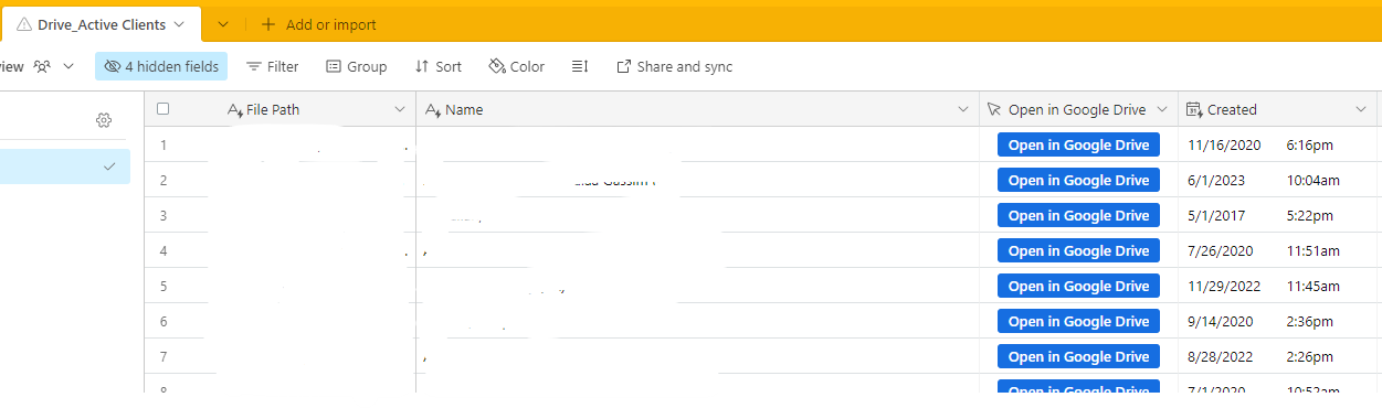

I have a table that is creating a record for each client that completes a form. I have another table on the same base which is a synced google drive table with all client folders. Is there a formula/automation I can use to link the "open in google drive" button from the synced drive table to the client table?

There should be a way to extract the url from the button, use a lookup to pull the url into the client table, then have a button field target the lookup of the url.

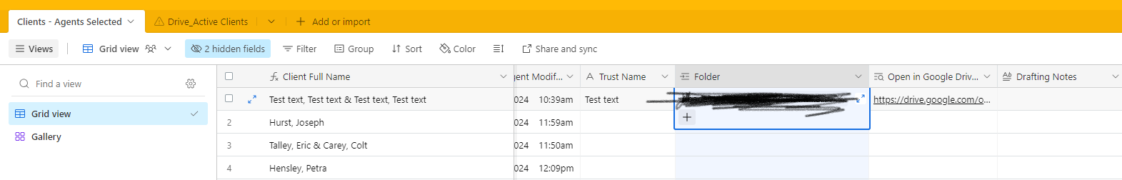

I am trying to get it so the highlighted folder field autopopulates in the client table when the name from the drive table matches the full name on the client table

Are you familiar with utilizing the in base automations? I believe you can have this triggered a couple different ways:
  • as running on a timer, on a scheduled basis
  • as a record in the clients table has the folder field empty.
    You can either link the records with the automation, or have the open in gdrive url pasted into the client record. Both have benefits. Your use case/need will ultimately help you decide. 🙂
I have the URL but I am struggling automating the lookup/linked fields between tables. I do not want to take the extra step of assigning a folder to a client form entry. Is there a way to automate a folder linking to a client record based on the name in between different tables on the same base?
Airtable has a guide on how to find and link existing records that you can find here: https://support.airtable.com/docs/linking-existing-records-using-automations
If I were you I'd use the guide above and trigger the automation when the form gets submitted, should do what you need!
