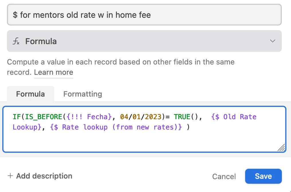

I'm not sure what I'm doing wrong with this formula. We are changing our pay rates on April 1st and I want to program my payment field to reflect this change. My table has a date field called "Fecha !!!" and a lookup field for our new rates and our old rates.
If the record has a date before April 1st I want it to use the old rates. If it has a date on or after April 1st I want it to use the new rates. Here's what I have so far! I'm a beginner! Thanks for your patience and  advice 🙂
You don't need the "=TRUE()" bit, and you need to format that April 1st as a date with DATETIME_PARSE(), so you'd end up with something like:
IF( IS_BEFORE( {Fecha !!!}, DATETIME_PARSE("01 04 2023", "DD MM YYYY") ), {Old Rate}, {New Rate} )

Thanks so much! Makes perfect sense!
