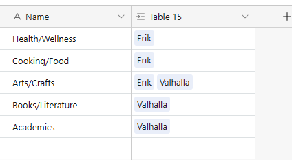

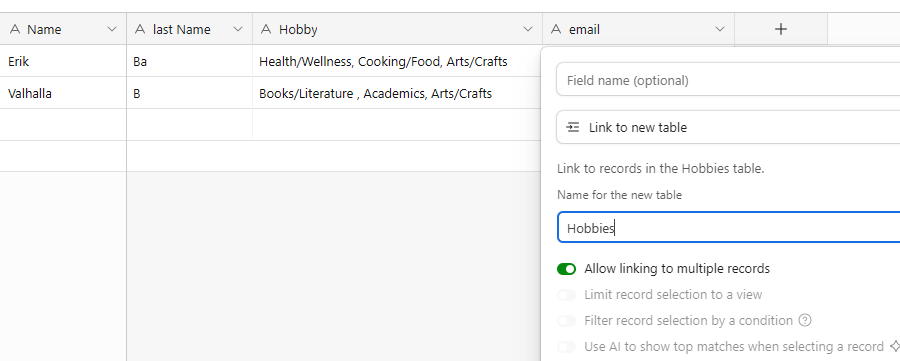

You are trying to script action, that in fact belongs to the core Airtable functionality.
Imagine you have only these 2 tables, and no links, just text data.
First thing you can do -  create link field to a new table, that will be a table of hobbies
then copy-paste whole hobbies field into link field
Hobbies table will be auto-populated
Now you can do the same with 2nd table (link to the same Hobbies table).
The you will see matches and using lookups and rollups, get other info you need.
