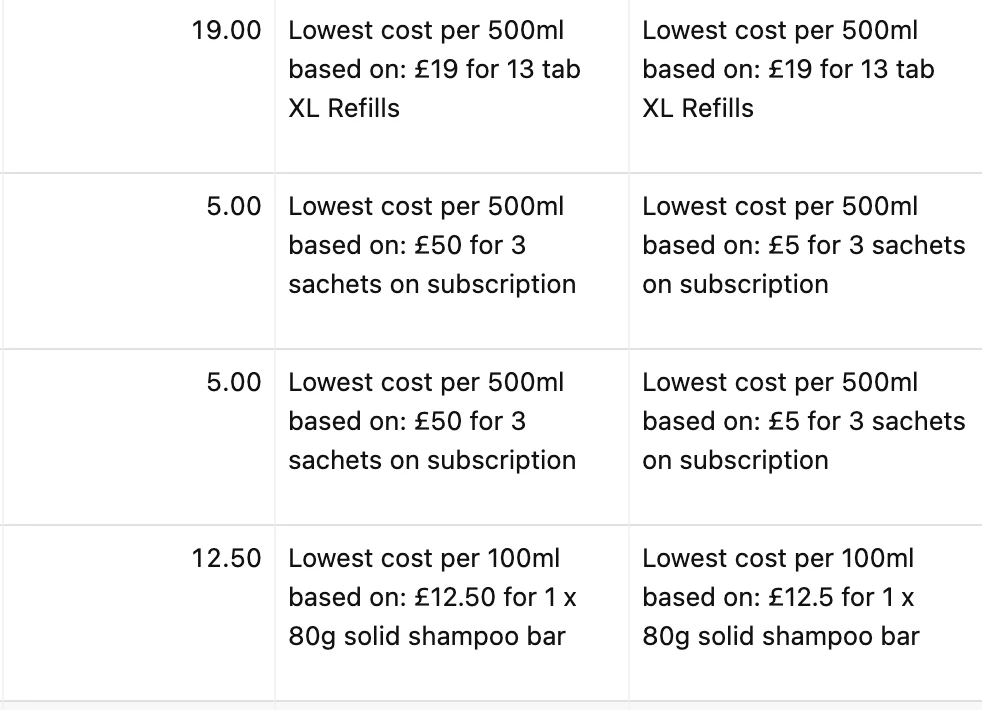

I am trying to format decimals in a formula to no avail:
  • To the left is the number
  • the 3rd column is what happens when this number is used in a formula (the end is cut off for numbers ending in 0) (e.g. 12.50 > £12.5
  • middle column is where I have formatted the number with this formula:
so this was a solution found on another thread:
IF({Refill / lowest price}, “£” & {Refill / lowest price} & IF(FIND(".", {Refill / lowest price} & “”) = LEN({Refill / lowest price} & “”) - 1, “0”))
However, if you now look at the middle column it works for the £12.50, but for any round numbers under 10 it misses the decimal place. (i.e. 5.00 > £50.
Any help with tweaking this formula would be greatly appreciated!
THANKS! :grinning_face_with_big_eyes:

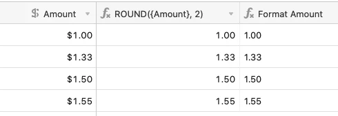

Hi Cassy, could you try the following formula and see if it works for you?
  Amount,
    FIND(".", Amount & ""),
      LEN(Amount & "") - FIND(".", Amount & "") = 1,
      Amount & "0",
      Amount
    Amount & ".00"

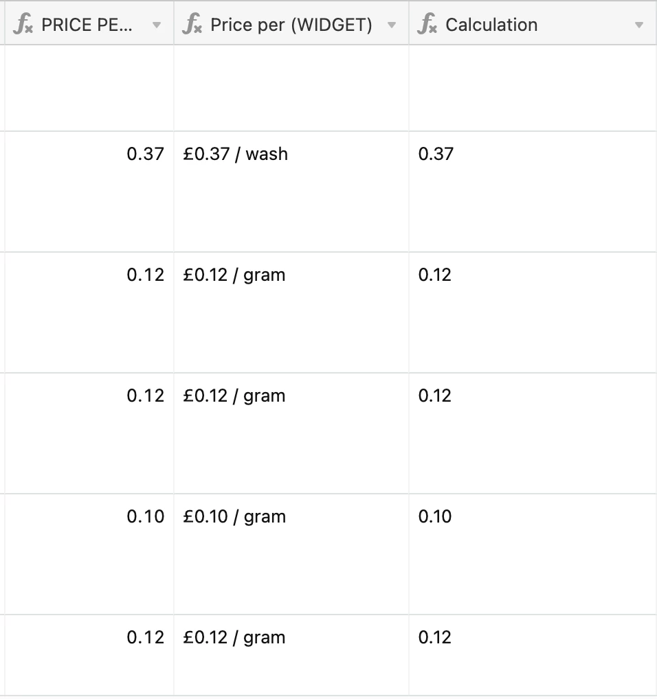

I have used the same formula in another area, and wondered if you could help with this too please?
  • middle is formatted number using:
ROUND({PRICE PER}, 2)
But once in a another formula it cuts off the 0
    1. The far right column is using your formula above
Thanks again!

Hi Cassy, hmm, could you share a link to your base with me so I can try to troubleshoot it?
I’ve tried to replicate your setup here but it seems to be working fine for me.

Adam, you’re a star, it works! I was choosing to either use the ROUND function OR your formula, but I realised it requires both:
  • Left column is amount formatted with:
  • Right column is your formula applied using the above already rounded number:
Amount,
FIND(".", Amount & “”),
LEN(Amount & “”) - FIND(".", Amount & “”) = 1,
Amount & “0”,
Amount
Amount & “.00”
  • Middle column is now pulling the finalised “double formatted” number.
Thanks so much for all your help!
