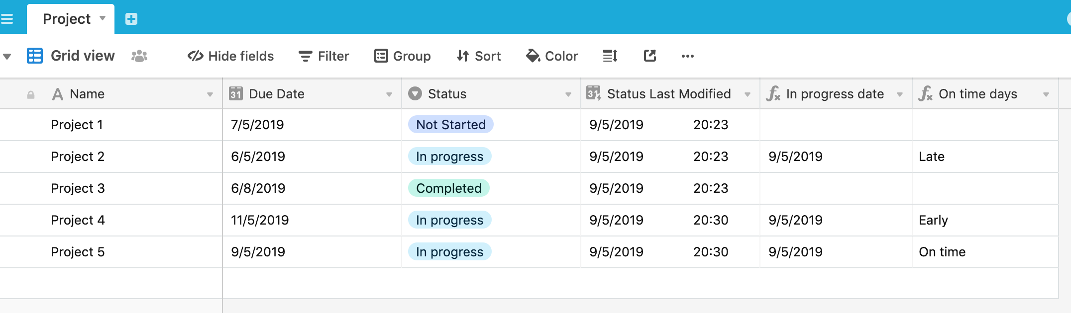

Hi @Candice_Garcia - how about this:

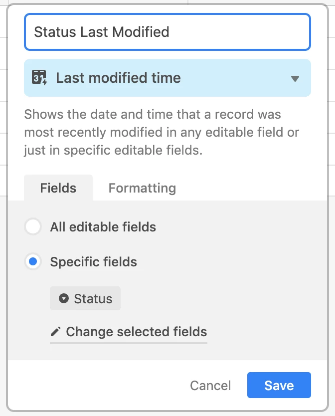

Name, Due Date and Status are self-explanatory. Status Last Modified uses the new Last Modified Time with this config:
So, only looking at the changes to the status field. At this point, it captures the last mod date for all statuses.
Let’s say you want to note changes to status where it is “in progress”. The next field - {In progress date} - shows this using the following formula:
IF(Status = 'In progress', {Status Last Modified}, BLANK())
Finally, the {On time days} field gives you the early/late/on time result using:
  {In progress date},
    DATETIME_DIFF({Due Date}, {In progress date}, 'days') = 0,
    'On time',
      DATETIME_DIFF({Due Date}, {In progress date}, 'days') > 0,
      'Early',
      'Late'
Does this do what you want?

Yes! That worked great! Thank you soo much for your help :slightly_smiling_face:
