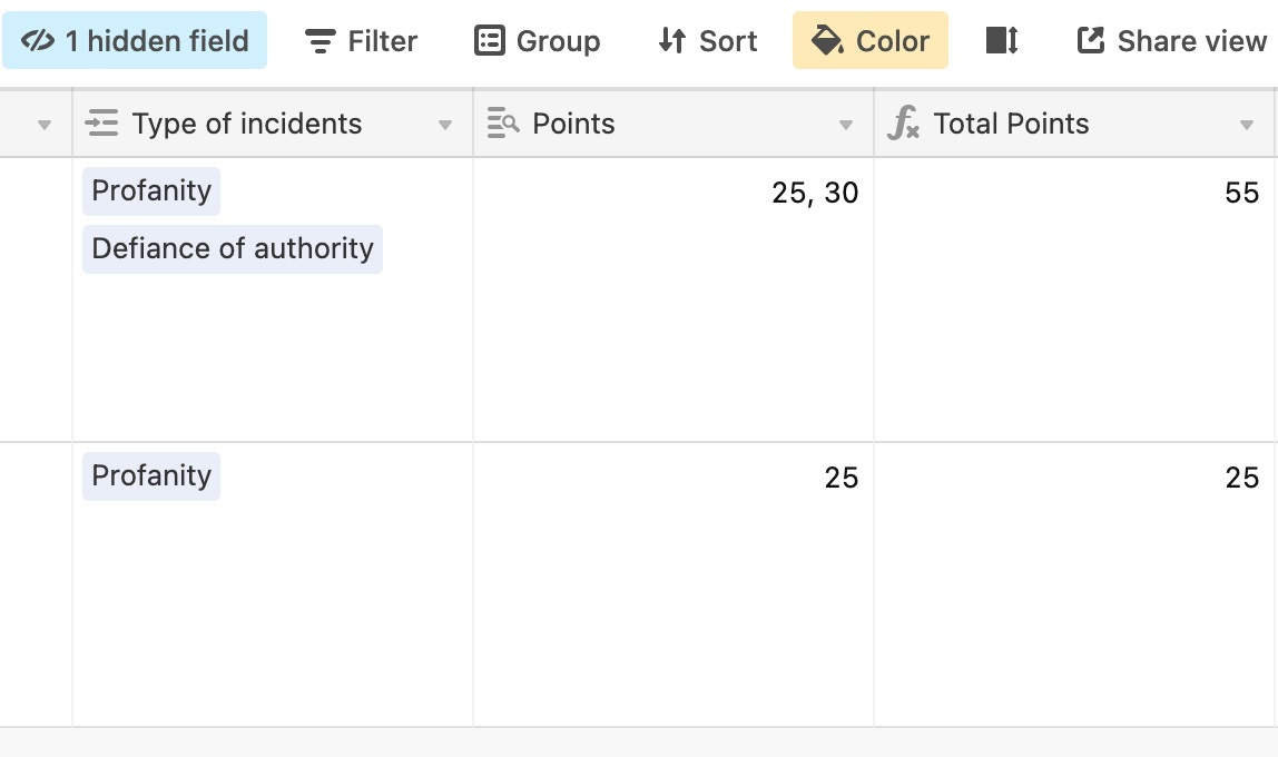

This tab is the incident report tab where we select the incident type and it adds the “points”

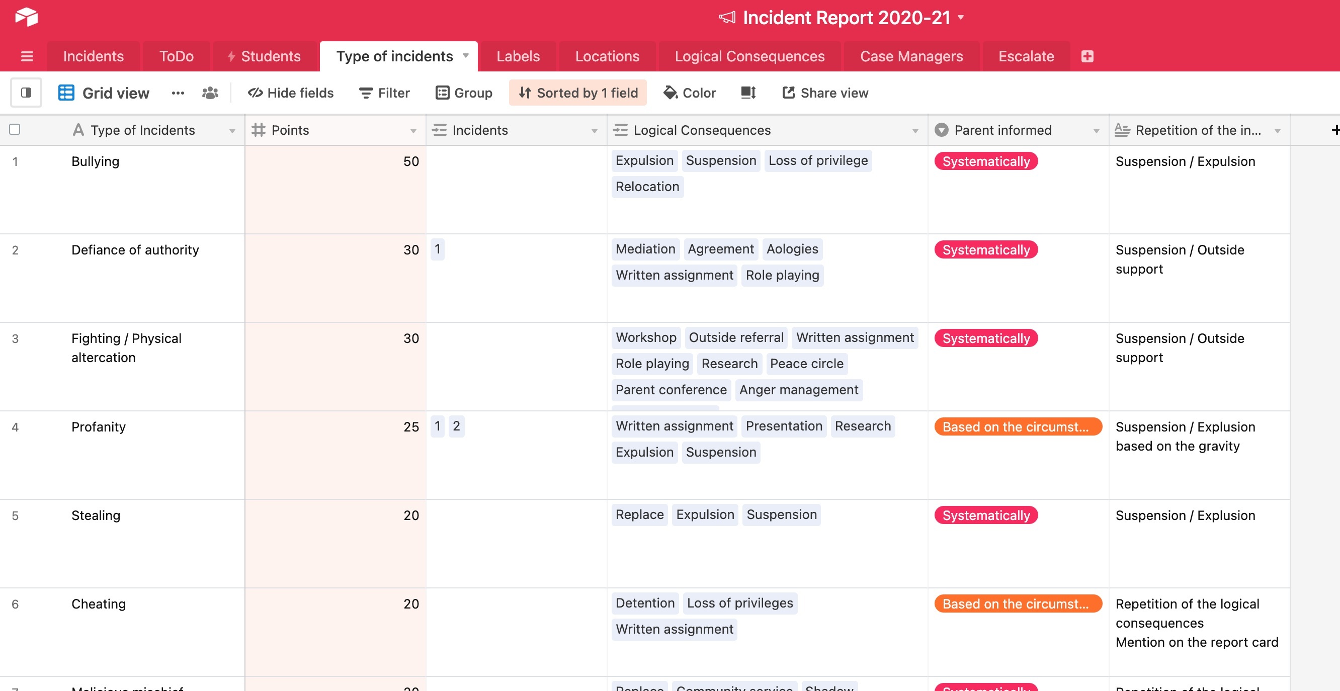

In this type we are listing all types of incidents including the weight they have (point)

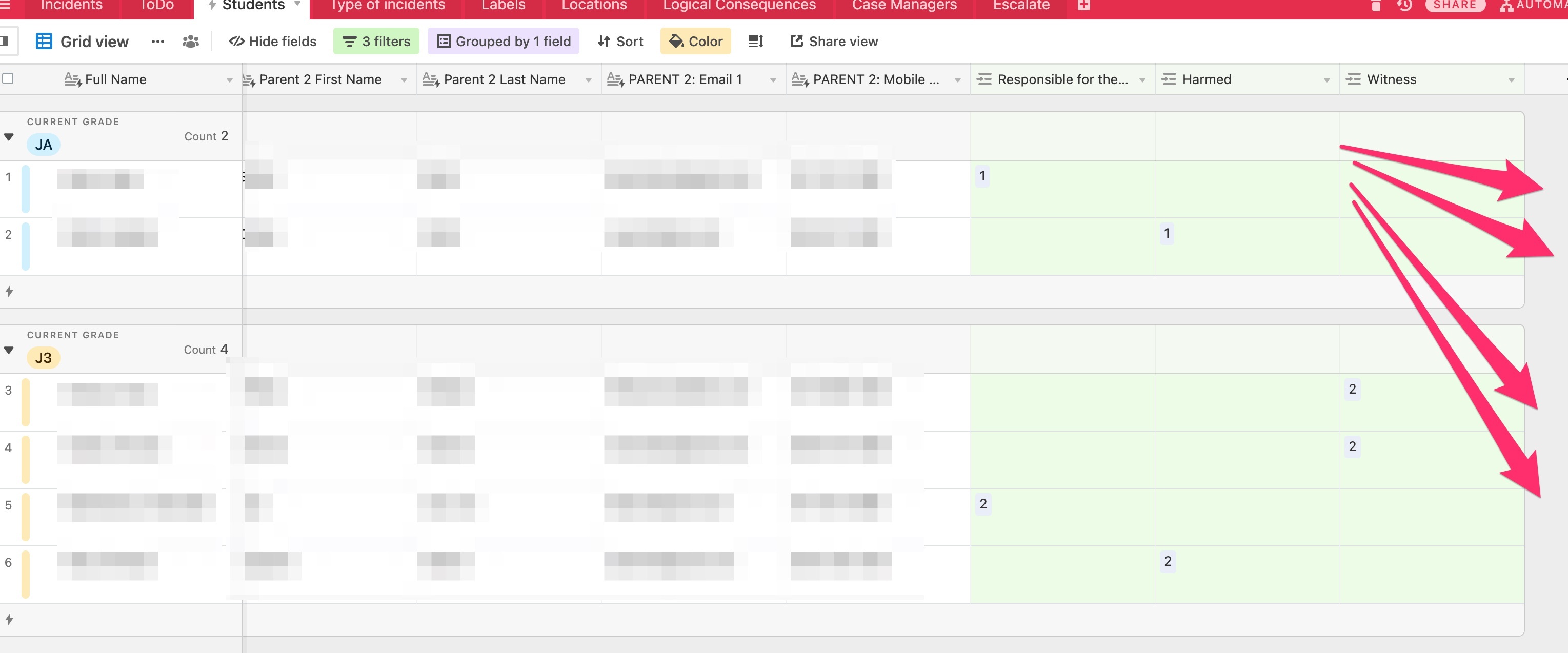

In this one we have all the information about our students which is used when you work on reporting an incident, I would like after the list of the incident on the right to add the total point they have.
