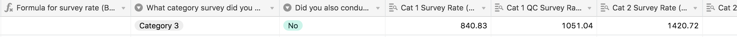

Hi - I am trying to write out a long nested IF statement and am having issues! Can anyone help with this formula?
IF(AND({What category survey did you work on?}=“Category 1”,{Did you also conduct Qual Coding?}=“No”),{Cat 1 Survey Rate (LC) (from Countries | 60dB base)},
IF(AND({What category survey did you work on?}=“Category 1”,{Did you also conduct Qual Coding?}=“Yes”),{Cat 1 QC Survey Rate (LC) (from Countries | 60dB base)},
IF(AND({What category survey did you work on?}=“Category 2”,{Did you also conduct Qual Coding?}=“No”), {Cat 2 Survey Rate (LC) (from Countries | 60dB base)},
IF(AND(
{What category survey did you work on?}=“Category 2”,{Did you also conduct Qual Coding?}=“Yes”),{Cat 2 QC Survey Rate (LC) (from Countries | 60dB base)},
IF(AND({What category survey did you work on?}=“Category 3”,{Did you also conduct Qual Coding?}=“Yes”),{Cat 3 QC Survey Rate (LC) (from Countries | 60dB base)},
IF(AND({What category survey did you work on?}=“Category 3”,{Did you also conduct Qual Coding?}=“No”), {Cat 3 Survey Rate (LC) (from Countries | 60dB base)}))))))

Hi Zollie, thank you so much! Appreciate your quick response.
Yes, exactly - I am trying to get a specific output e.g. “Cat 1 Survey Rate…” based on a set of criteria (Category survey and whether the response to one of the questions is Yes/No). Essentially a conditional lookup but within one table.
