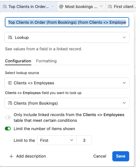

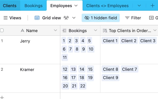

Doable, we'd just need to run two automations every time a booking is created, and your rankings would be kept up to date in real time!  How you want the data displayed will affect the setup though, and so I'm going to assume you're okay with displaying the top 3 clients per employee in a lookup field in descending order like so:

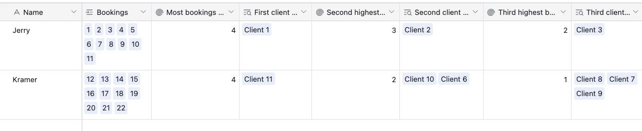

You could also set it up so that it shows each client in its own cell with the count of bookings too, but that's more work to set up so I figured I'd just pass you this first

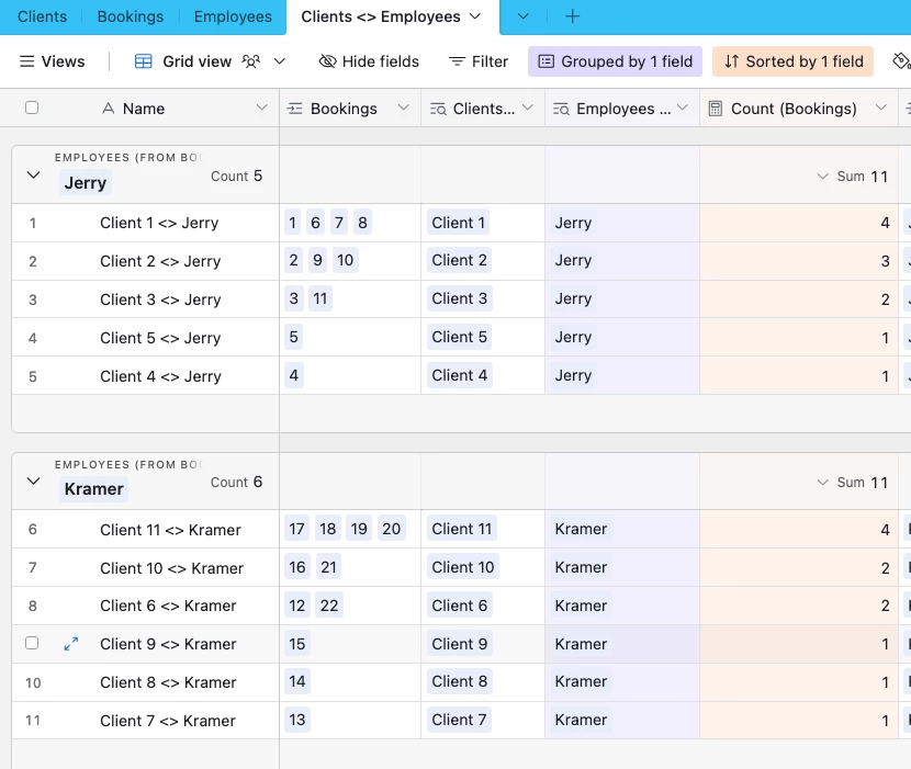

To get this to work you'll first need to create a third table where each record represents a link between a Client and an Employee (let's call that 'Clients <> Employees'), and then you could use a Count field to get the number of bookings, then sort by that:
After that, you'd

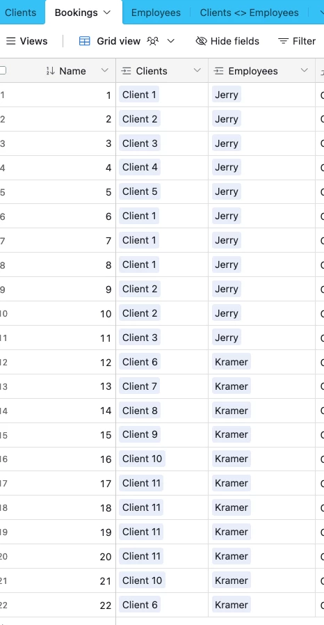

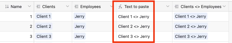

1. Create a formula field in Bookings to output the text '[CLIENT] <> [EMPLOYEE]'
2. Create an automation that would trigger whenever a new Booking record was created with the 'Client' and 'Employee' fields filled in, and make it paste into the linked field to 'Clients <> Employees', which helps you populate the data
3. Create another automation that will trigger whenever the 'Bookings' field in 'Clients <> Employees' is updated, and its actions will be
  - Find all the records in 'Clients <> Employees' that are linked to this Employee via the lookup field
  - Sort that list by the Count field
  - Update the record in 'Employee' with that sorted list
4. Make the lookup field in Employees display the First 3
And done!
