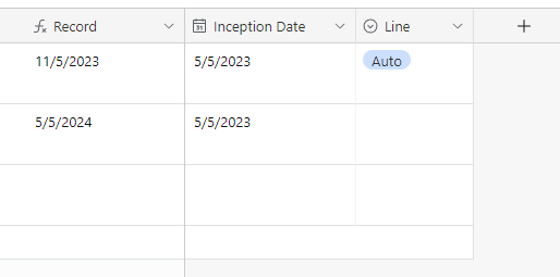

@ccreamer11 I worked on this for a minute this morning.  The diffifulity in what you are asking is that AT needs to know which side of the half year mark you are on.  I was hoping that DATETIME_DIFF would provide a decimal equivalent of 'years' to make this easier but it appears to only push integers.  Try this below and see if it works for you.
   {Inception Date}>{TODAY()},
   DATETIME_FORMAT({Inception Date}, 'D-M-YYYY'),
      AND(
         {Line}="Auto",
         (DATETIME_DIFF({TODAY()}, {Inception Date},'M')) <
         ((DATETIME_DIFF({TODAY()}, {Inception Date},'Y')*12)+6)
      DATETIME_FORMAT(
         DATEADD({Inception Date}, (DATETIME_DIFF({TODAY()}, {Inception Date},'y')*12)+6, 'M'),
         'D-M-YYYY'
      DATETIME_FORMAT(
         DATEADD({Inception Date}, DATETIME_DIFF({TODAY()}, {Inception Date},'y')+1, 'y'),
         'D-M-YYYY'
This can be simplified a bit if you allow AT to format your dates which would make the equation:
   {Inception Date}>TODAY(),
   {Inception Date},
      AND(
         {Line}="Auto",
         (DATETIME_DIFF(TODAY(), {Inception Date},'M')) <
         ((DATETIME_DIFF(TODAY(), {Inception Date},'Y')*12)+6)
         DATEADD({Inception Date}, (DATETIME_DIFF(TODAY(), {Inception Date},'y')*12)+6, 'M'),
         DATEADD({Inception Date}, DATETIME_DIFF(TODAY(), {Inception Date},'y')+1, 'y')
It works within my test base https://airtable.com/shr3QB0wkQibMdKvB where I changed out TODAY() to a field called TODAY(C) so I could quickly change the "day of the year" and see how the formula behaved.
