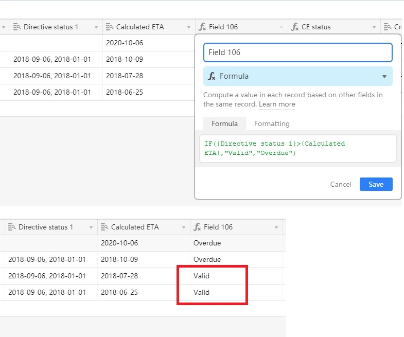

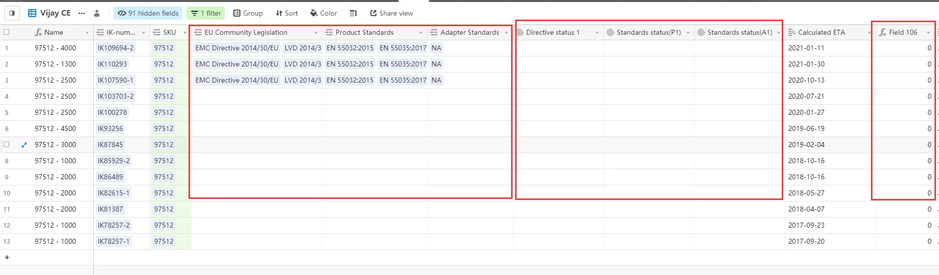

How can we make a judgment between each date in column {Directive status 1} cell and the date in Column {Calculated ETA}, and then return the “Overdue” if one judgment result is false?
Or how do I get the smallest date in column {Directive status 1} cell.

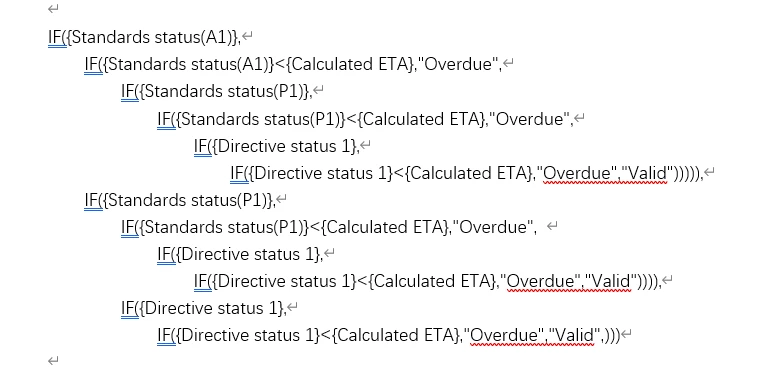

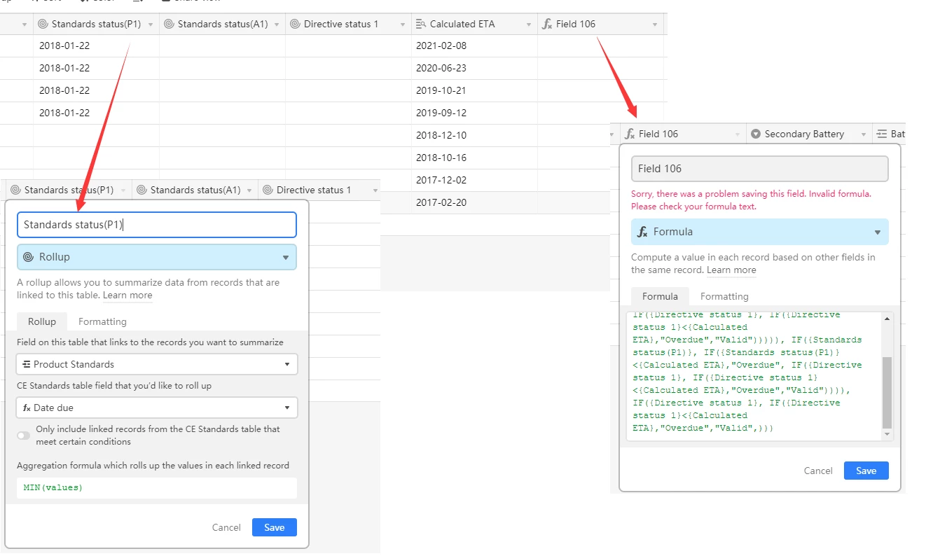

Then I have some questions below:
1, Rollup→IF(MIN(values),IF(MIN(values)>{Calculated ETA},‘Valid’,‘Overdue’)), why the return values is blank?
2, Why formula that MIN({Standards status(P1)},{Standards status(A1),{Directive status 1}}, return 0, not a date?( Based on the case where all three columns have values)
3, Why the following formula is error? (My thinking is that if 3 column are blank, return ‘Valid’, if one of date of 3 column is small than {Calculated ETA}, return ‘Overdue’)

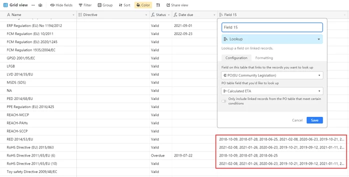

Sorry, For your said that" 2. Next to that source/target field, add a Lookup field that pulls in the {Calculated ETA} field." will get the problem of looking up a lot of dates because this links a lot of data. (like following picture).

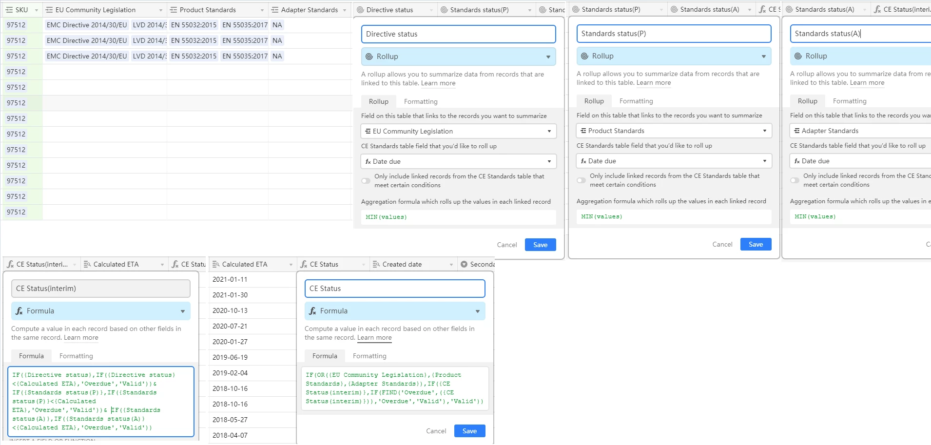

and my question is solved, you can see the last picture, thank you for you help(very big help for idea)
