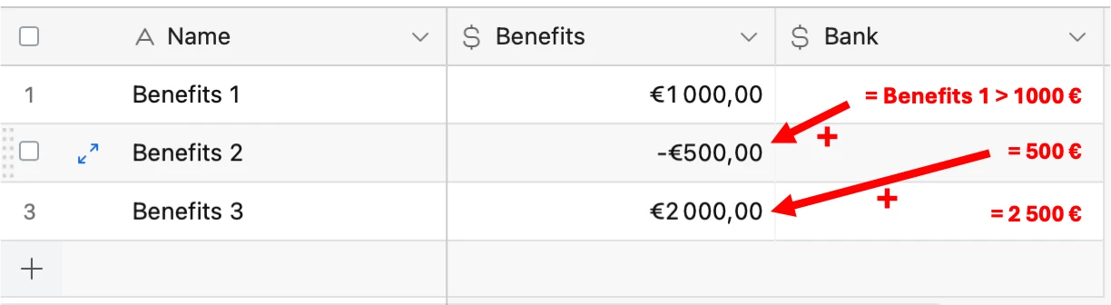

I am trying to add cells together in order to find the line by line tracking.
For example, in the image below, I am looking to add up the different profits in order to obtain the amount present in the bank account.
Can you help me ?
Thanks !

Thanks Adam.
I don't know how to use scripts.
Do you have an example of the second option?
I have already seen this possibility in Airtable Community but I have never been able to set it up.
Thanks,
Benjamin.

It looks like you want a running total. One of the examples in the Scripting Documentation is for a running total.
Note that this script works best in Scripting Extension, and run from a button. As written, it will work as an automation script only if there are a very limited number of records in the view.
Overall, I do not recommend using a non-scripting automation for calculating a running total. Non-scripting methods tend to need a lot of automation runs.
