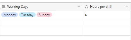

I have workers schedules and sometimes they work Monday to Friday, but sometimes they work, say, every other day and some of their shifts fall during the weekend or during a national holiday. So I have a field with multiple select where it shows which days they (will) work and how many hours - from there multiply the number of days by the hours to get the total payable hours per week and consequently the total pay for the week.

Now this is what I am trying to tackle, but backwards. I have the preliminary working days of the week (as per the original screenshot) - a multiple select field.
Is there a way to grab each one of the selected options, convert the string to a weekday, then check in the upcoming month how many of each selected there are - how many Mondays there are, how many Wednesdays and so on, and to sum up those numbers?

But again, my problem is how to convert the multiple select weekday options to values for a formula.
