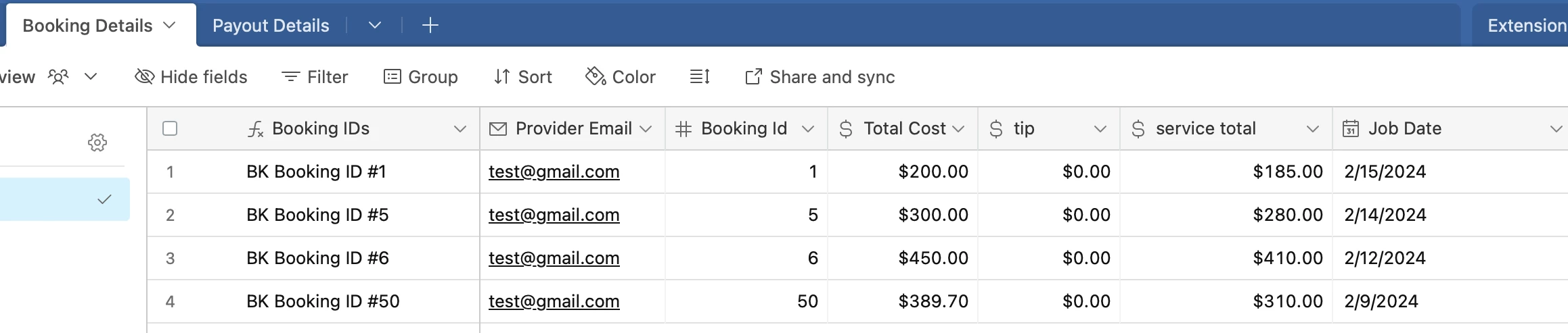

1. Booking Details: ignore the entry at the bottom, it's not part of the pretend work week

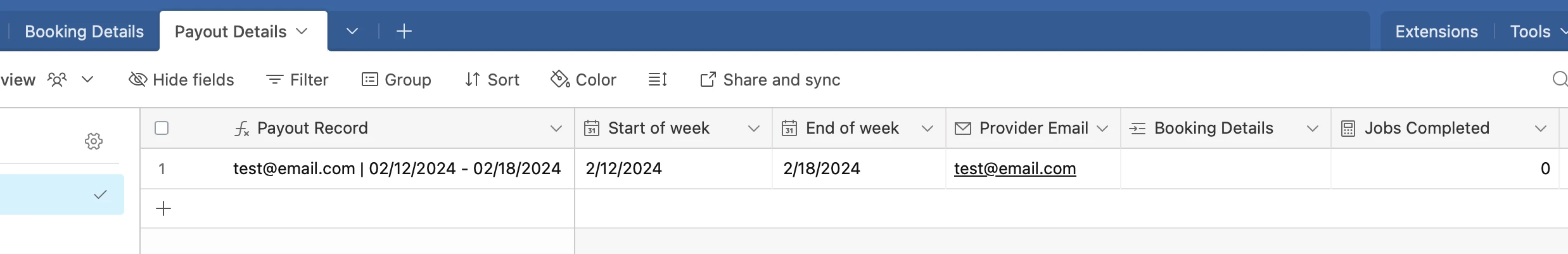

2. Payout Detailsā€ƒ
Now, The info from table 1 contains a job record: who worked it, the price, the date, etc. In this case, all those jobs were worked by "test@gmail.com" (one person). These jobs were done in different days but in the same Work week of Feb.12-Feb.18.
Table 2 is supposed to put all the jobs together from this work week and combine them into 1 record: who worked them, the names of the jobs... which would go under booking details (name: from table 1, first column), and add the total of jobs completed.
Now, for table 2, the reason I put start date and end date (although I know this is not going to resolve my problem) is because I wanted to show how I want it to appear in the "payout record". I want the email of the person and the work week to appear in the payout record.

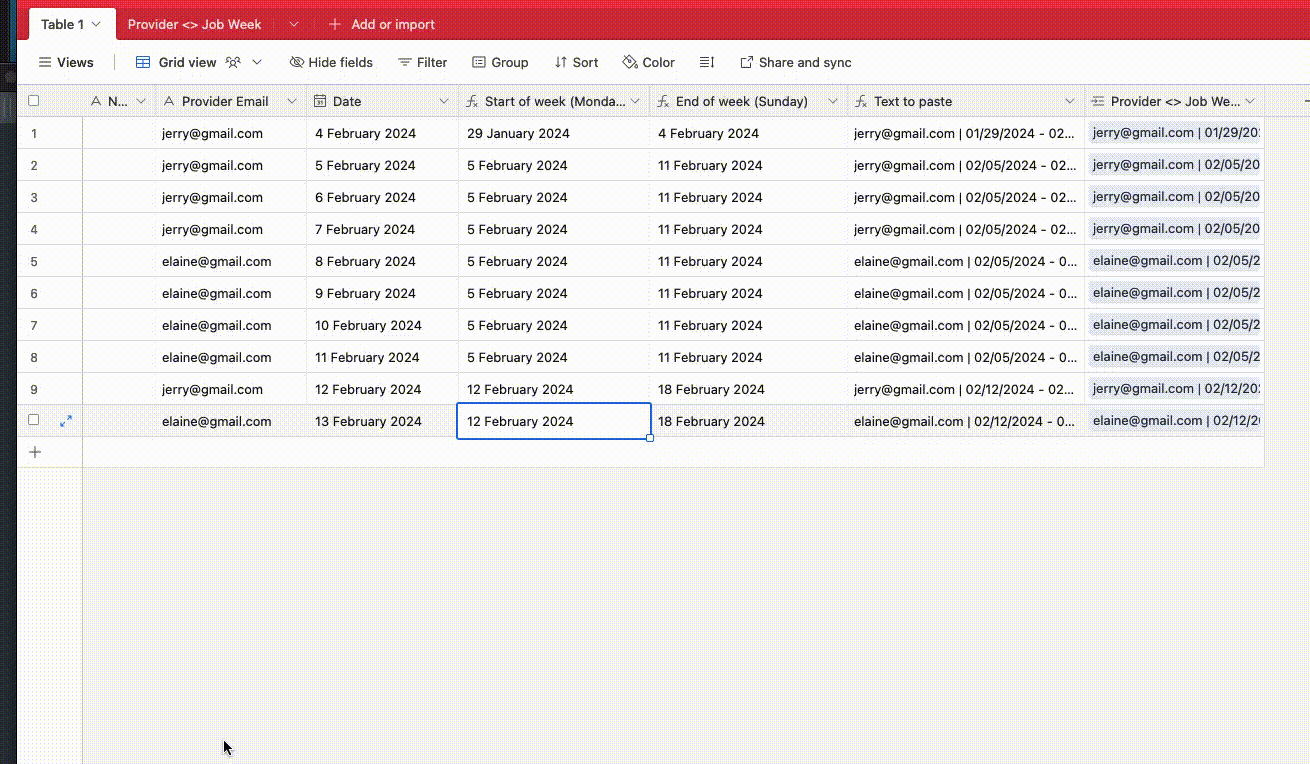

Ahh, sorry to hear that.  I've built something for you here that should do what you're looking for
It includes the formulas to calculate the start and end of the job week, as well as the automation to link them together.  You can view the formulas once you duplicate the base to your own workspace!
