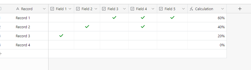

Okay, so from what you're describing, I'm imagining something like this:
Here's the formula I used:
IF( OR( {Field 1}, {Field 2}, {Field 3}, {Field 4}, {Field 5} ), SUM({Field 1}, {Field 2}, {Field 3}, {Field 4}, {Field 5}) / 5, 0 )
Naturally, if you decide to add additional fields later on, you'll need to update the divisor in the equation.
Additionally, the 0 in the falsy parameter for the IF() function is optional.
If you want the formula to return nothing if the fields are all blank, then you can omit the 0.
If you always want a value to be returned, in this case a 0%, then you can just leave it in.

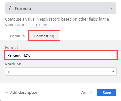

Be sure to confirm that your formula formatting is correctly configured.
