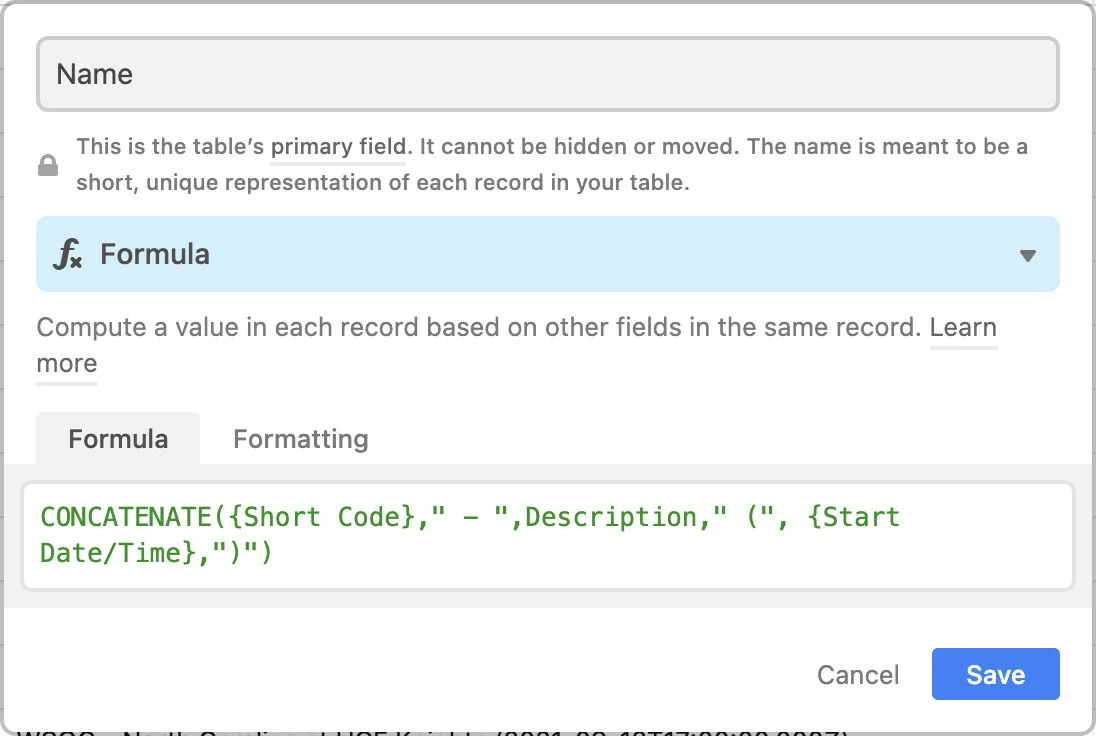

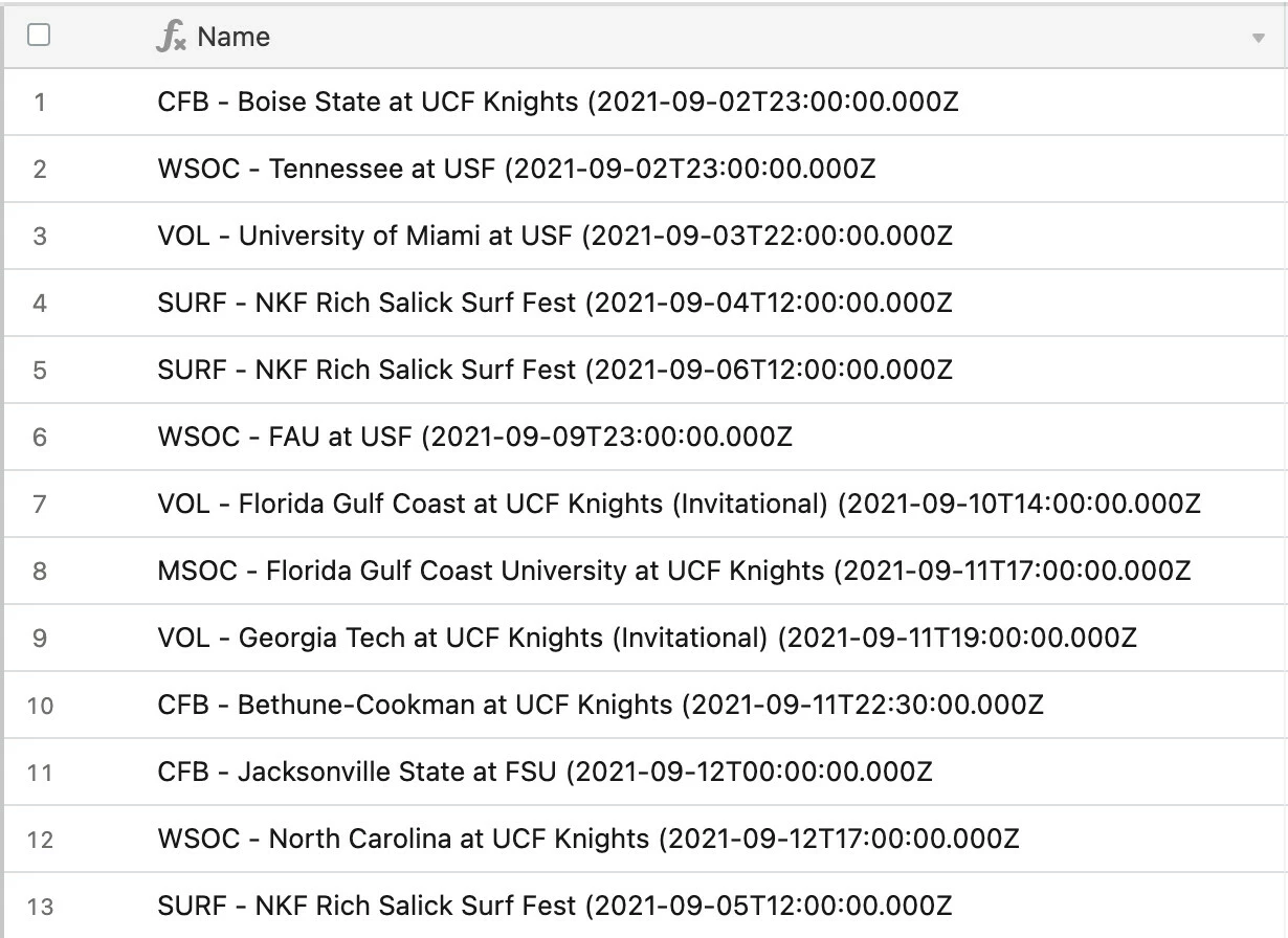

Hello, can someone help me figure out how to add ONLY the Start Date to a field? Currently, it is adding both the Start Date and Start Time. See images for my current formula. Thank you!

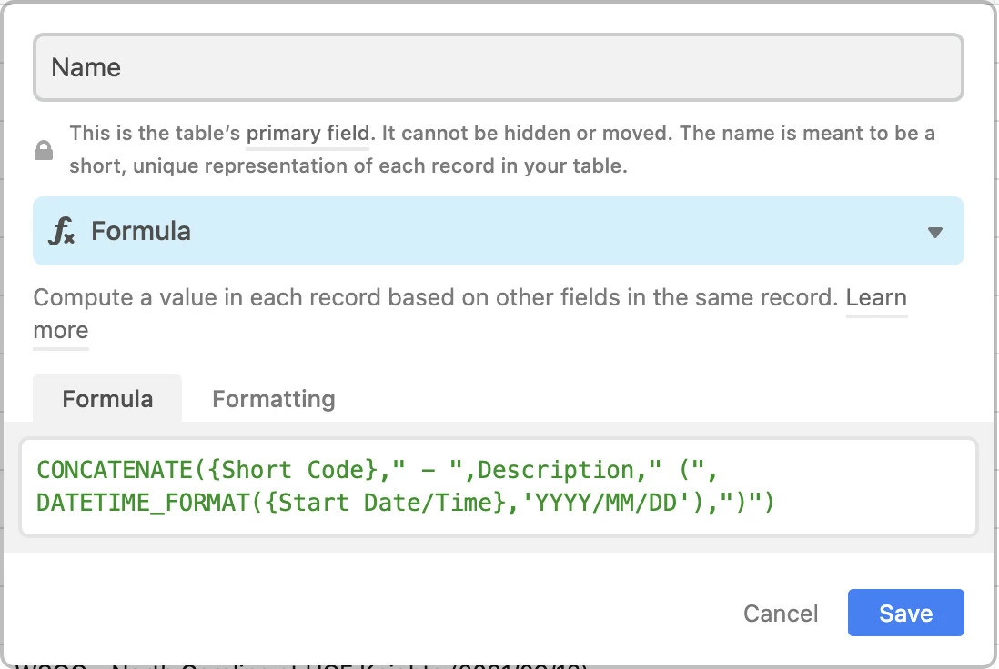

Hi @Kelly_Smy
Take a look at the DATETIME_FORMAT() function here:
And the format specifiers you can use with it here:
You’ll just wrap the {Start Date/Time} part of your formula in the DATETIME_FORMAT() function.
It might be worth noting that you can simplify your CONCATENATE() formula can be simplified a bit by combining the literal string parts; ie,
could become just

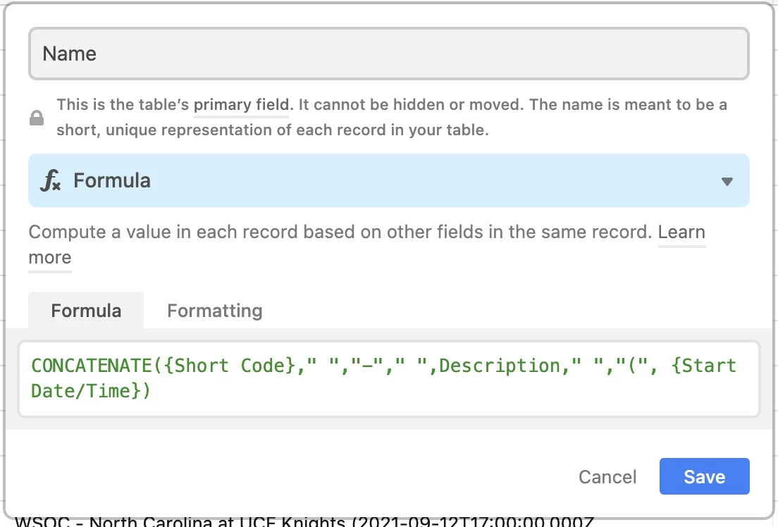

Thank you for that information. I hate to sound like a complete noob but I don’t quite understand when you that “I’ll just wrap the {Start Date/Time} part of your formula in the DATETIME_FORMAT() function”?
I tried adding the "DATETIME_FORMAT(‘YYYY/MM/DD’) after the {Start Date/Time} string but it came back with an #ERROR in the property field. I’m not sure where the DATETIME_FORMAT needs to go?

I fixed it, it worked. Thank you so much!
