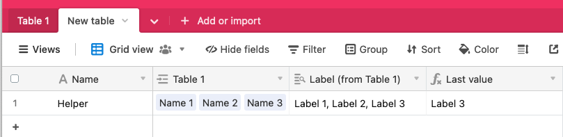

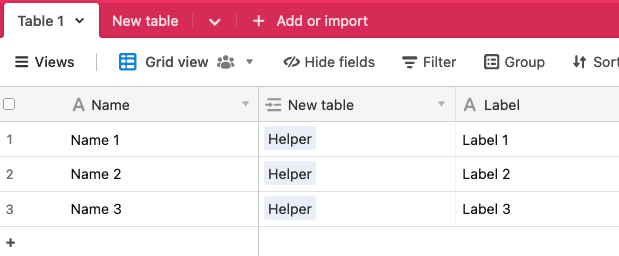

You could use good ol' regex for this:
And the formula used is:
REGEX_EXTRACT( ARRAYJOIN({Label (from Table 1)}), '[^,]*$' )
This'll break if your values contain commas though, but given you're talking about ranks it probably doesn't?  Let me know if it does tho and I'll see if I can figure something out

  • February 8, 2023
Link to base
Thank you @TheTimeSavingCo! I tried using that Regex formula you shared and it worked perfectly!
Problem solved! 😁
