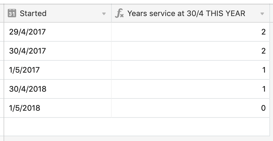

Hi @Jacqui_Birchall - I think this gives you what you want:
The formula is:
DATETIME_DIFF(DATETIME_PARSE('30/4/' & DATETIME_FORMAT(TODAY(), 'YYYY'), 'DD/M/YYYY'), Started, 'years')
It compares the “started” date with 30th April THIS YEAR (result shown in whole years)
JB
The formula is:
JB
