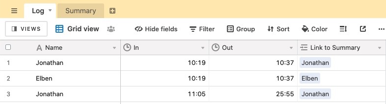

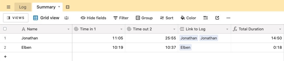

@Jeremy_Oglesby I may be missing a detail here, but using duration fields (both for the timestamps, and for the rollup field format) plus linking records between tables should work out.

Ah, actually I see the problem with my response above - you’d need separate rollup fields to log multiple in/out timestamps, and then sum up the duration of all of them combined.

Thanks Jason,
For some reason I also end up with overlap on times from Zoom, so this would end up duplicating minutes - but I did a double take becuase its a very logical suggestion!
