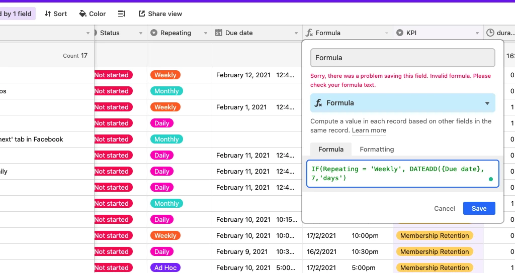

Hello,
I am trying to get repeating tasks to work based on their regularity (Daily, Weekly, Monthly) with the IF and DATEADD formula used together. Here is what I have tried:
Can anyone suggest where I am going wrong?

Hi Hazel. Well, it looks like your formula needs another closing right paren. If you want to add in the capabilities for monthly & daily, then add another IF… right after “7, ‘days’)”
,IF(Repeating=‘Monthly’…

Thanks for your help, unfortunately it is still not working for me… this is what I have now as the basic weekly formula:
IF(Repeating = ‘Weekly’, DATEADD ({Due date} ,7,‘days’))
Perhaps I am going wrong elsewhere…

So I just recreated everything to match what you’re doing and it works for me. One thing that stands out to me that I don’t understand is that green circle in the formula window of the screen snip you shared.
You clearly had formula in there before that worked, as I can see the values in lower rows. Is there more of the formula in the window that we can’t see?
I’m stumped.

Yes, you are right, I have the DATEADD part working but not the Repeating… All sorted now - thank you for all your suggestions!
