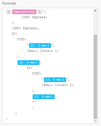

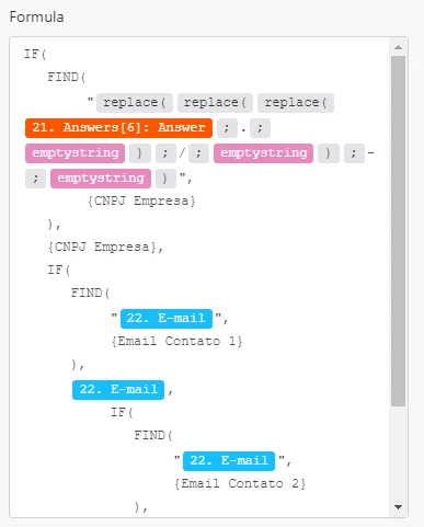

I made a formula in integromat but it is not working as expected. It is below, but since integromat formulas change a bit because we can change the data before it goes to airtable, i’m also sending pictures.
pasting it looks like this
FIND(
“{{replace(replace(replace(21.answers[6].answer; “.”; emptystring); “/”; emptystring); “-”; emptystring)}}”,
{CNPJ Empresa}
“{CNPJ Empresa}”,
FIND(
“{{22.E-mail}}”,
{Email Contato 1}
“{{22.E-mail}}”,
FIND(
“{{22.E-mail}}”,
{Email Contato 2}
“{{22.E-mail}}”,
What could be wrong? Sometimes it returns results without any match, so it should be empty.

After looking at this again, I think that I misunderstood your original goal. By searching to find either the CNPJ in the {CNPJ Empresa} field, or the email address in one of the two email fields, you’re actually trying to end up with a matching Airtable record, which will be processed in the rest of the scenario. Is that correct? If so, then the design of the formula is definitely wrong, at least in terms of how it should be designed specifically for use in Integromat.
The Formula field in the Airtable module in Integromat isn’t used in quite the same way as you’d use it in Airtable itself. In the latter case, you’re typically returning data to display directly in the formula field. However, what you’re trying to do in Integromat is find a matching record (or series of records, depending on your use case), using a formula to determine whether each record in the specified table is or isn’t a match. In other words, you don’t want the data from the field, so your formula shouldn’t return actual field data like it does now. You just need to know if the record matches, so the formula should return either TRUE or FALSE. If it’s TRUE, Integromat will pass the record to the rest of the scenario. If it’s FALSE, it won’t pass.
With that in mind, I believe your formula should be:
OR(FIND("{{22.CNPJ}}", {CNPJ Empresa}), FIND("{{22.E-mail}}", {Email Contato 1}), FIND("{{22.E-mail}}", {Email Contato 2}))
The OR() function will return TRUE if any of the conditions inside it are true, or return a TRUE-equivalent value like a positive number. So if the CNPJ is found in the {CNPJ Empresa} field, or the email address is found in either of the two email fields, the record will be considered a match, and will process accordingly.

Justin,
I tried what you said in your first tip, but it didn’t work, it returned me an error when i deleted the “”
but thinking about your 2nd tip, I tried changing the CNPJ to be sure it doesn’t match any CNPJ and changed the email to be sure it would be find, but it didn’t! It is like the formula doesn’t get through the first IF and only FIND for CNPJ, and if it is false, it returns empty, instead of following the FIND email 1 and 2 formula.
Justin,
To be more clear, you need to omit both the quotes and the comma before them, so the end of your formula would look like this:
    FIND(
        "{{22.E-mail}}",
        {Email Contato 2}
    "{{22.E-mail}}"
Not sure why you’re not getting through with the rest of the formula. You might try testing the output of those nested replace functions in Integromat. I haven’t used that function myself, but maybe something there is creating a false-positive for that first FIND().
