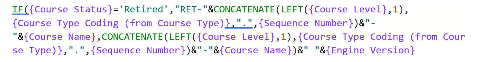

I have a formula that currently works:
IF({Course Status}='Retired',"RET-"&CONCATENATE(LEFT({Course Level},1),
{Course Type Coding (from Course Type)},".",{Sequence Number})&"-"&{Course Name},CONCATENATE(LEFT({Course Level},1),{Course Type Coding (from Course Type)},".",{Sequence Number})&"-"&{Course Name})&" "&{Engine Version}

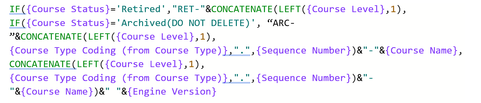

However, I now need to add an additional IF statement to check for Archived:
IF({Course Status}='Archived(DO NOT DELETE)', “ARC-”&CONCATENATE(LEFT({Course Level},1),
As you can guess, my second IF apparently isn't working.
I get the formula has an error.
Any help would be appreciated.
Sean
Forum|alt.badge.img+7
Hello @Sean_Lake1
It looks like your issue is more about closing out statements with a paren than anything.  The formula should read:
"RET-"&CONCATENATE(LEFT({Course Level},1), ""),
  "ARC-"&CONCATENATE(LEFT({Course Level},1),
{Course Type Coding (from Course Type)},".",{Sequence Number})&"-"&{Course Name}))&" "&{Engine Version}
The first Concatenate line was still looking for some level of input and the paren to complete its function.  Also the end of the equation did not fully close out the first IF statement with a paren.  The midde "ARC-" is using curly quotes not straight quotes which also causes issues.  You can tell that AT is not picking up that a string because it is not colored.

Sean_Lake1
Forum|alt.badge.img+20
Your first solution, worked, however the bottom one wiped out all the data!  No worries, ctrl-z fixed it fast!  Thanks!
Sean_Lake1
  • May 16, 2023
I finally got it.  AT support(Sean K), and I worked on it, but when we logged off, I hadn't noticed that the FULL field was opened and it'd duplicated the course id 2x. EEK!
No worries, I worked it out:
SWITCH({Course Status},"Retired","RET-"&CONCATENATE(LEFT({Course Level},1),{Course Type Coding (from Course Type)},".",{Sequence Number})&"-"&{Course Name}&" "&{Engine Version},
"Archived(DO NOT DELETE)","ARC-"&
CONCATENATE(LEFT({Course Level},1),{Course Type Coding (from Course Type)},".",{Sequence Number})&"-"&{Course Name}&" "&{Engine Version})
Making it pretty, also led to breaking, so this is how I wound up writing it into the formula field.
PHEW, one down!
