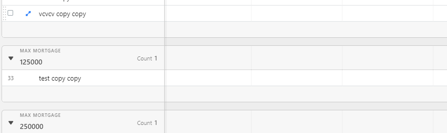

The formula works perfect, now the table looks different:
The line above is theusual line, but where something is calculated with the formula, the whole line looks different. is that normal? can I turn this of so that I just have plain lines?
PS I mean the 2nd and 3rd line where it says MAx mortgage (Name of the field row) and count 1) THANK YOU
You are grouping your records. Turn off the grouping.
