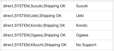

Hi guys, I was about to post a similar question where i saw @Katy_Richards question.
I believe the answer for Katy’s question will also answer mine.
	FIND(‘Ueki',  {Order Tags} & ‘’),
	‘Ueki’,
      		FIND(‘Ogawa',  {Order Tags} & ‘’),
    		‘Ogawa’,
	      		FIND(‘Suzuki',  {Order Tags} & ‘’),
    			‘Suzuki’,
      				FIND(‘Morita',  {Order Tags} & ‘’),
	    			‘Morita’,
      					FIND(‘Kondo',  {Order Tags} & ‘’),
    					‘Kondo’,
 	     					FIND('Inoue',  {Order Tags} & ‘’),
   						‘Inoue’,
						'No Support'
Our {Order Tags} will include results such as “direct, SYSTEM, Suzuki, ShippingOK.”
Essentially, I have Shopify’s order tags being sent over to Airtable, and would like to Make a formula column that is designated to the person’s name providing support for the order.

This kind of searching can be simplified using a regular expression:
    REGEX_MATCH({Order Tags} & "", "Ueki|Ogawa|Suzuki|Kondo|Inoue"),
    REGEX_EXTRACT({Order Tags} & "", "Ueki|Ogawa|Suzuki|Kondo|Inoue"),
    "No Support"
To address @Katy_Richards’ situation, the formula would look like this:
    REGEX_MATCH({Lookup Correct Section} & "", "Senior|Intermediate|Junior"),
    REGEX_EXTRACT({Lookup Correct Section} & "", "Senior|Intermediate|Junior")
Thank you Justin, it worked like a charm!
It was something ive been struggling for a while, so thank you!
