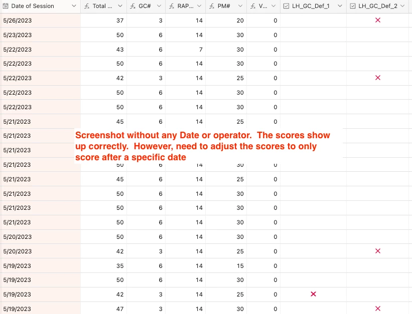

Question on the following formula.  I have tried just about anything and everything to get this formula field to only calculate the score based on after the date.  The formula works perfectly fine without using any date fields.
Form type (single choice option), LH_GC_Def_1 (checkbox) field.
Current working formula for field GC#

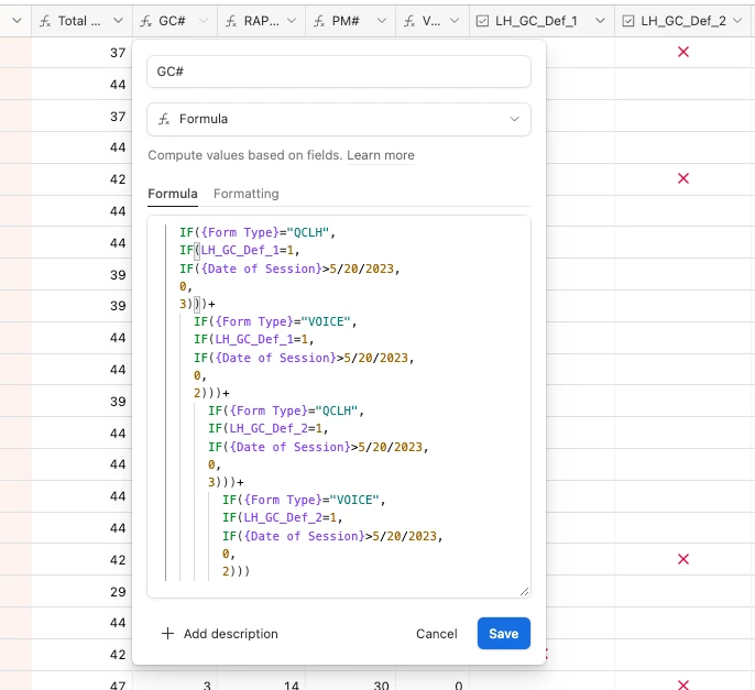

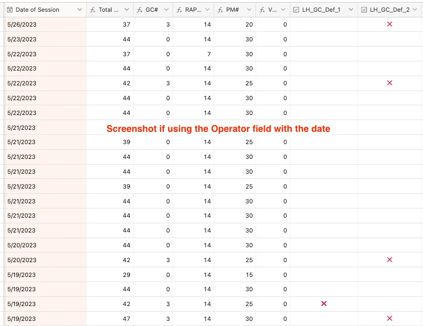

If I try to add in the date field to the GC# column (date of session field) using an operator, it looks like some portions are scored correctly and some are completely wrong, like it is only counting a portion.
I have also tried to use IS_AFTER but the formula fails to work, or pulls up an ERROR!.
Any thoughts?

In your third screenshot, the dates you've supplied need to be adjusted to be understood as dates. You're not seeing an error here b/c Airtable is reading these as 5 divided by 20 divided by 2023.
Try replacing them with:
DATETIME_PARSE('5/20/2023')
DATETIME_PARSE() converts a text based date into an actual date that Airtable can use in calculations.
Hope that helps!
-Stephen
Hi @Stephen_Orr1  I gave that a try and still didn't work.  Wasn't sure as that field within AirTable is a date column field type.  I tried to add the formula below and it goes through but the scoring is almost like it is avoiding a portion of the fields to get the exact scoring.
IF({Form Type}="QCLH",
IF({LH_GC_Def_1}=1,
IF({Date of Session}<DATETIME_PARSE('5/20/2023'),
0,
3)))+
IF({Form Type}="VOICE",
IF({LH_GC_Def_1}=1,
0,
2)))+
IF({LH_GC_Def_2}=1,
0,
3)))+
IF({LH_GC_Def_2}=1,
0,
2)))
Outcome: Any records with LH_GC_Def_2 = checked the score comes to 3 with records after 5/20/2023 (Which is correct).  However all records after 5/20/2023 with neither Def1 or Def2 checked should = 6 total points (3 per).  This is the same results I keep receiving.  If I remove any fields associated with the date, the scoring formula works perfectly fine.
