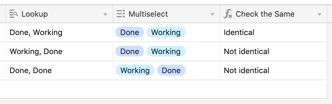

Hi @EAugum - I’m not totally sure how your data is represented, but I’m thinking one of two ways. The first works out of the box:
In the case, on the multi-select the done and working values are the selectable options.

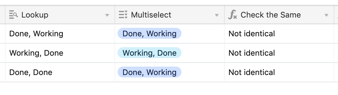

But I think this isn’t your case given the data you describe - maybe more like this?
Where there are different combinations of done and working in each select option?

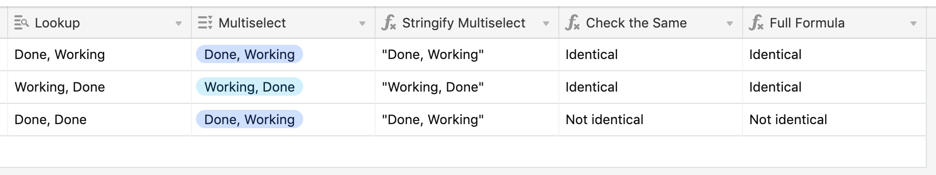

If so, then you need to turn the multi-select into a string before doing the comparison:
The Stringify field is:
Multiselect & ''
The Check the Same field is:
IF(Lookup = SUBSTITUTE({Stringify Multiselect}, '"', ''), 'Identical', 'Not identical')
Note that the SUBSTITUTE element removes the double quotes in the stringify field
And you can combine this into a single formula - the final field - with:
IF(Lookup = SUBSTITUTE((Multiselect & ''), '"', ''), 'Identical', 'Not identical')

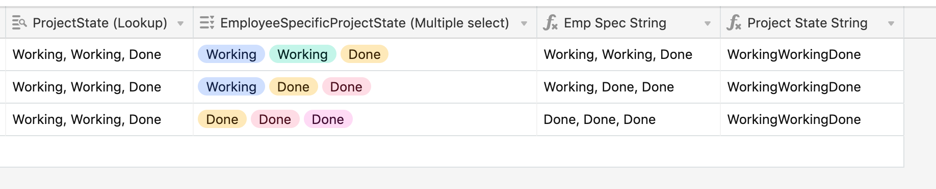

Actually, your first example is somewhat close to what my case looks like. However, while I was making this example base, I realized maybe my challenge is that I have more of the same “state” selected in the Multiple select.
I made a simple example base: https://airtable.com/shr1SdLKZfwfYlETD
At the first row in the Employees-table, you will see my issue.
Project State (Lookup) does seem to be matching EmployeeSpecificProjectState (Multiple select), but the IF-formula field says it’s not.
Does this help explain my problem?

Yep, that’s it - if you stringify the two fields using this formula:
'' & {Your field name}
You can see that two values are different so when you compare you get “not identical”:
So…you probably want to do a SUBSTITUTE on the Emp Spec String to get rid of “comma, space”, then do the comparison.
