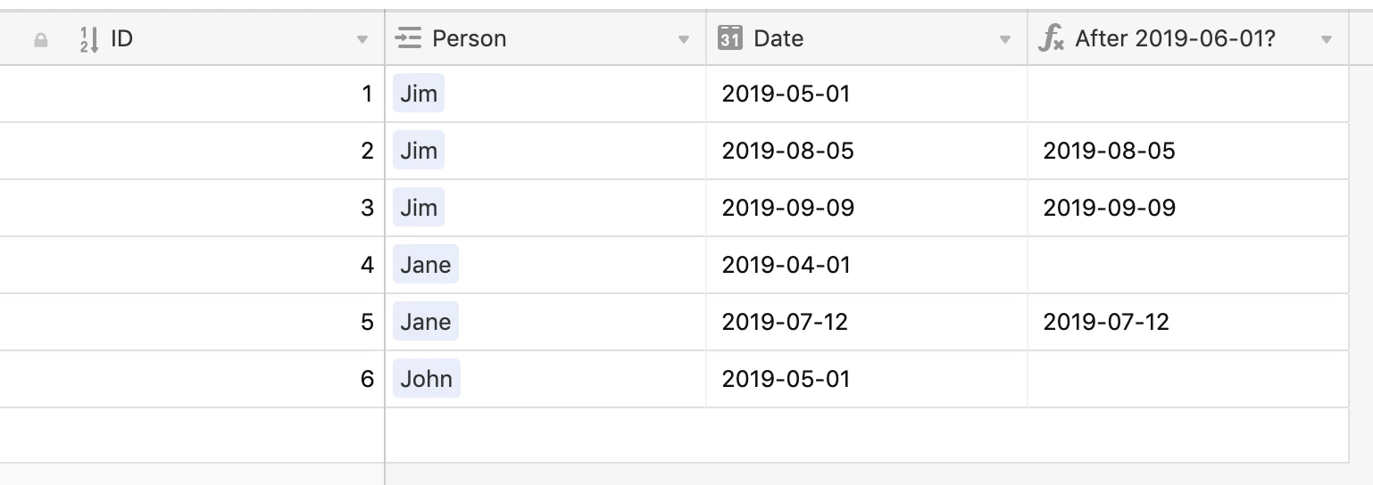

In your Visits table have a field that uses this formula:
IF(IS_AFTER(Date, '2019-06-01'), Date)
To show the visit date if it is after the specified date (modify as required) or nothing if it is before the specified date:

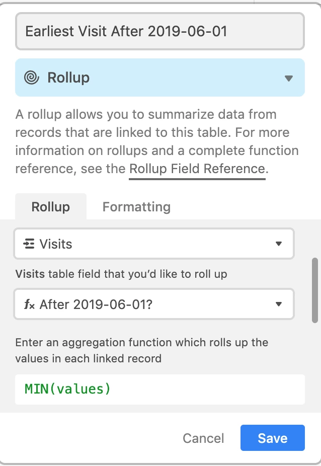

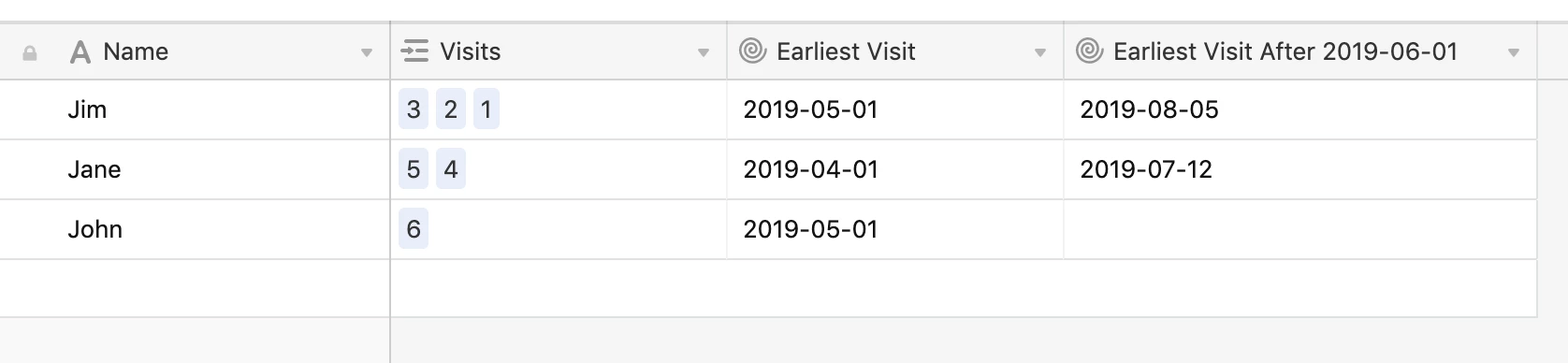

Back in your People table you can roll up this field (and the date field if you want) to show the earliest visit after the specified date:
The rollup field uses the MIN(values) setting:

This worked! Thank you so much!
