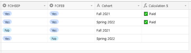

I’m hitting a wall, but got at least halfway to the solution! I have two scenarios that I’d want to return a given statement.
Option A: Someone has a “Yes” in FCIHSEP and a “Fall 2021” in Cohort
Option B: Someone has a “Yes” in FCIFEB and a “Spring 2022” in Cohort
Either of those should meet the criteria to return the “ :white_check_mark: Paid” statement.
I got it to work for Option A, but I’m a bit stuck on how to build in Option B as an alternate way to satisfy the statement.
What I have so far:
IF(AND(FCIHSEP = “Yes”, Cohort = “Fall 2021”),“ :white_check_mark: Paid”)
Any help is greatly appreciated!
Best answer by Vivid-Squid
Hi @gretchen
I think I understand what you are asking for. Can you try this formula?
  OR(AND(FCIHSEP="Yes",Cohort="Fall 2021"),
  AND(FCIFEB="Yes",Cohort="Spring 2022")),"✅ Paid")

THANK YOU. I wish you could have seen my face when that actually worked. I know it was probably the simplest fix, but I was struggling. Thank you for your help!
