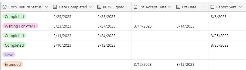

So look like this, I want to have another Field with formula, where 8879 Signed filled = Waiting for PMT, Ext Accept Date filled = Extended, Report Sent filled = Completed, 3 of that fields are empty = New, so I can get rid of the Status column and everything should be automatically whenever I filled the Date information

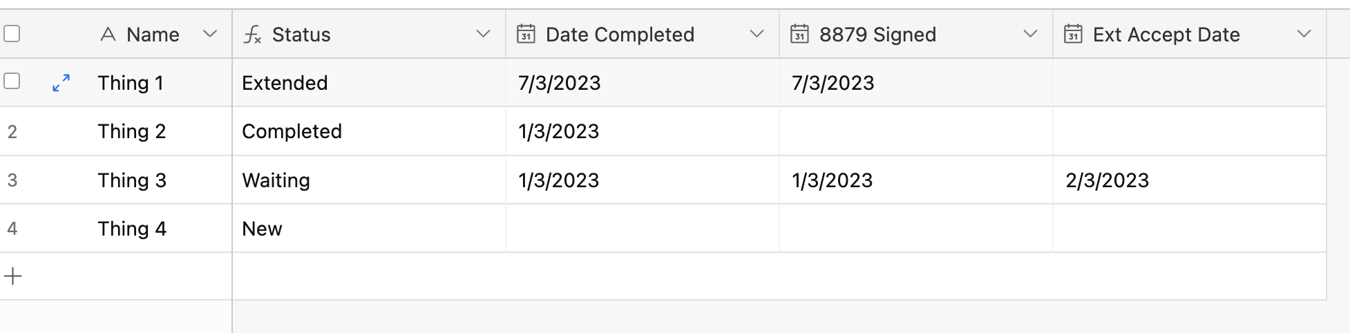

I might be misunderstanding but if this is what you are trying to accomplish then it should be possible with the formula I posted below!
Here you can see the formula:
IF({Ext Accept Date}, "Waiting", IF({8879 Signed}, "Extended", IF({Date Completed}, "Completed", "New")))
