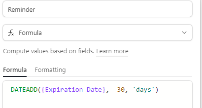

I have a similar question...
I want a reminder field to calculate 30 days before a contract is going to expire. But sometimes, there is no "due date". In those instances, the "reminder" field should be blank. Currently it says #ERROR.
How can I change this reminder field formula?
